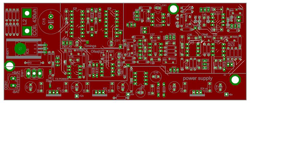

            perhaps this is a good pcb .I want your opinion.
            will present a comprehensive,When finished TESTING.Click image for larger version
Name:	superscan psb 1-05-2016.JPG
              Very nice, like a factory PCB...
                        will present a comprehensive,When finished TESTING.[ATTACH]36257[/ATTACH]
                        NICE.

                              • #45
                                Thanks, i understand it. The 2.2ohm is out of the 3300 micro capacitors circuit.... The 2.2ohr resistor is for charge the capacitor.
