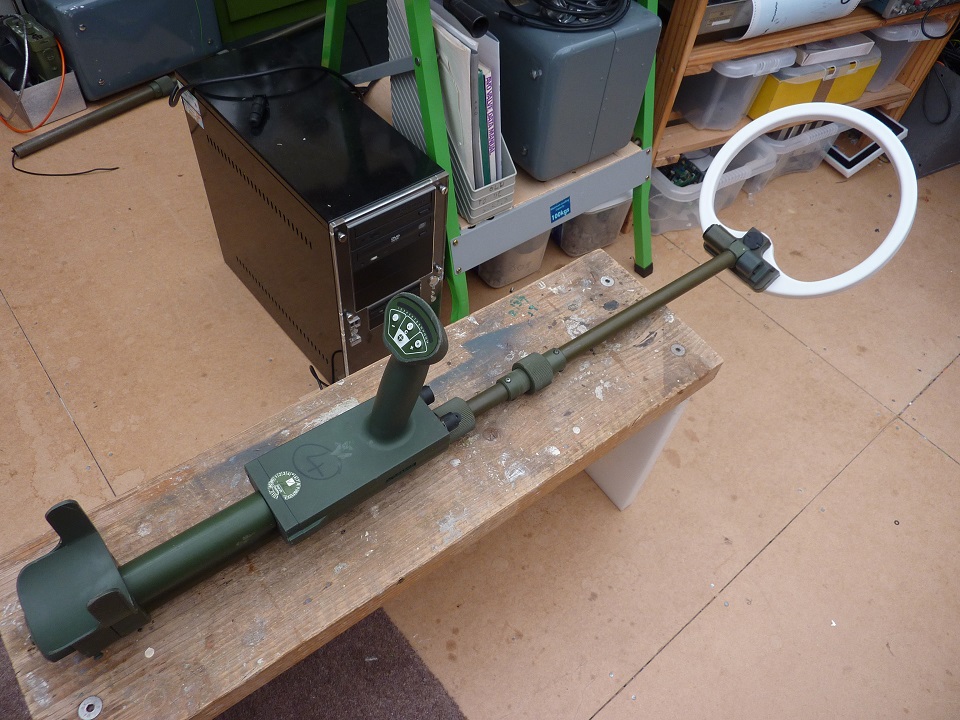

                  • VMH3CSEF
                    Looks more the part for beach and nugget hunting with the 11in search head.Click image for larger version

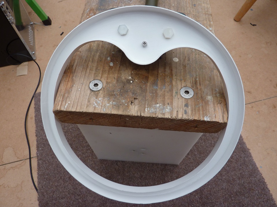

                    The coil winding has yet to be mounted are then there are two stages of potting.
                    The swivel is held in place by two M8 nylon bolts and one stainless steel bolt and nut (non-detectable) Click image for larger version

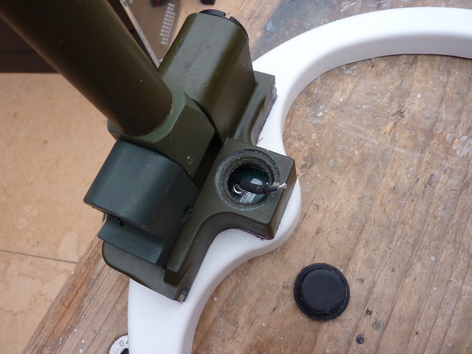

                    The cable in the shaft goes through the swivel with three O ring seals and a two turn coiled section to allow free adjustments to the coil angle. The coil wire ends will come up into the recess on the top of the swivel in which there is a little PC with two pins. This is where the cable and coil are joined. The circular cover with O ring then seals everything in. Click image for larger version

                    The VMH3CSEF should be ready to test on the beach by the weekend.
