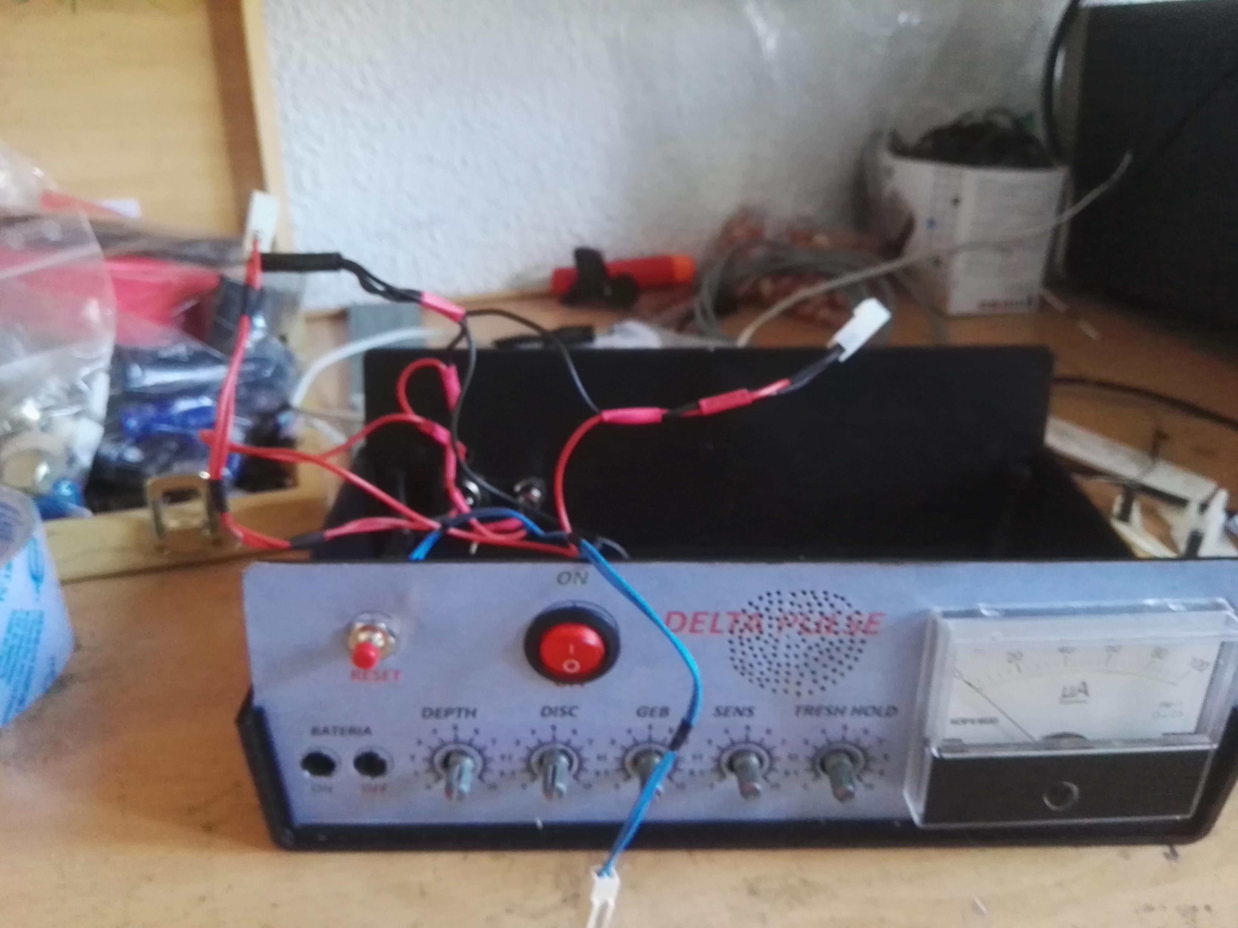

                      • #41
                        [Adjuntar] 40660 [/ ATTACH]
                        • #42
                          • #43
                            depth - PULSE WIDTH - in microseconds. scale from 100 to 500. or what you see really on your board.
                            disc - MAIN STROBE DELAY - in usecs. scale from 40 to 160. or what you see really.
                            GEB - SECOND STROBE DELAY - in usecs x 100. from 1 to 8, ie from 100 to 800. or what you see really on board.
                            remake.
