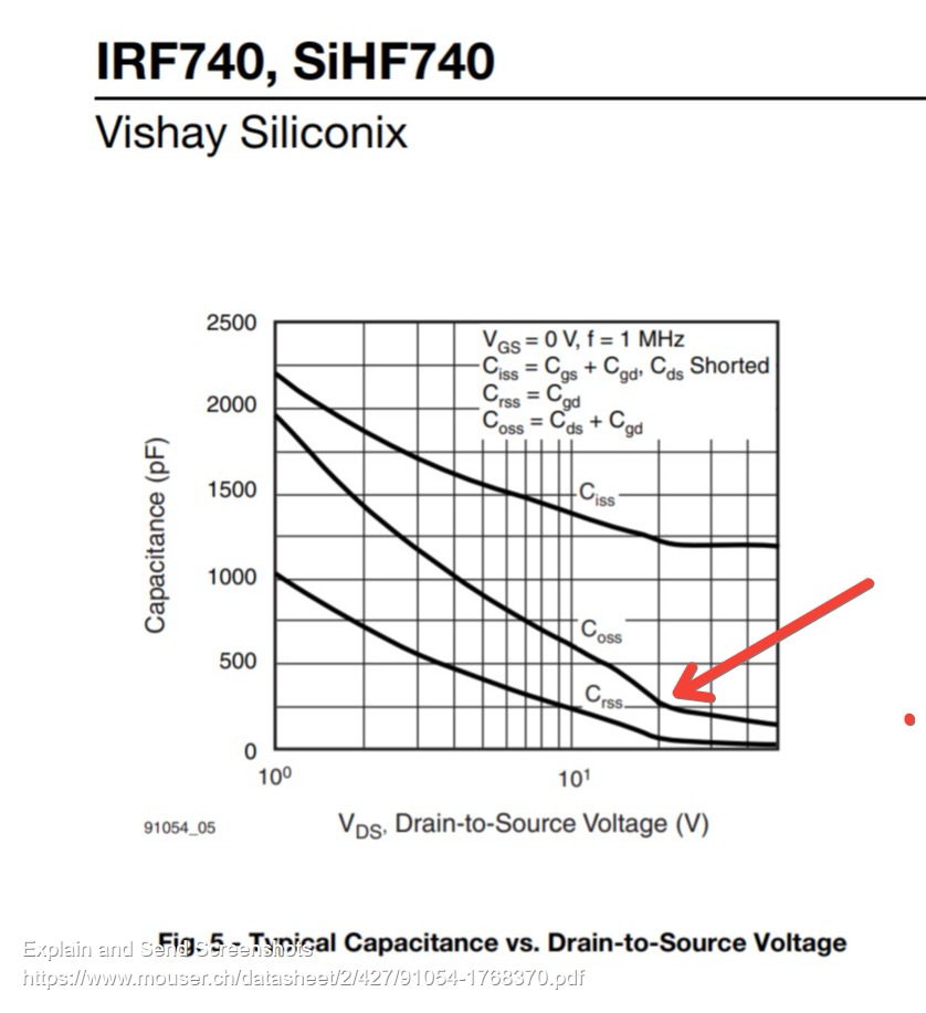

        Attached is the graph showing the Drain to Source capacitance of the Mosfet IRF740.
        At about 200V is what I call the sweet spot, where the Coss starts increasing fast, as the voltage diminishes.
        At 0 Volt the Coss is highest.

                • Originally posted by Monolith View Post
                  That's an interesting observation, although it's difficult to determine the exact values from looking at the graph in the datasheet.
                  With reference to Appendix D of "The Voodoo Project", where I investigated the use of a series diode in a PI TX circuit, there is an equation for Coss effective. In the case of the IRF740, Coss effective was calculated as 211pF at a voltage of 320V. This appears to more or less match the graph that you posted.
                  Coss effective is defined as a fixed capacitance that would give the same charging time as the output capacitance of a mosfet while VDS is rising from zero to 80% VDS with VGS = 0V.
                      Intrigued by your calculation for "Coss effective" I looked at some datasheets.
                      Looking at the Coss of IRF740B or IRF740AS series and comparing with the diode MUR460 Junction capacitance, it becomes obvious, that the diode may not always be of much benefit.
                            Reading a lot of datasheets and comparing the many available parts in detail has become imperative.
                            From a combination of calculation and simulation it appears that the diode eliminates about 50% of the mosfet capacitance, but how much improvement you see in practice depends on what you're trying to achieve. Either way, the diode doesn't make things worse.

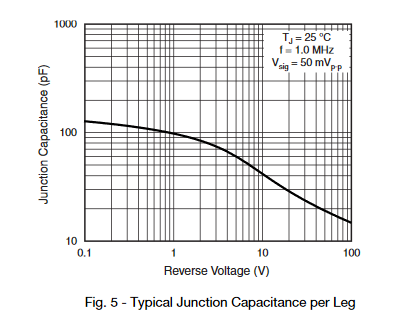

                              The MUR460 also benefits from holding upwards of 100V reverse potential on the drain/cathode junction reducing the capacitance to around 15pF.
                                [ATTACH]54627[/ATTACH]
                                Eric, as your previous thread on the subject had shown, not all diodes are suitable for producing these effects. In my own experiments, I have successfully used the through hole mur460 and BYV28-200 (as used in the SD2000). For SMD's I have successfully used the MURS320, MURS340, and MURS360. I keep a stock of about 10 each BYV28-200's, MURS320, and MURS340 on hand. Simulation shows that almost any diode will work, but in the real world they don't... I have tried general purpose diodes with very disappointing outcomes. I once tried a 1004 because simulation showed that it would work... IT DIDN'T!! Eric, I guess all you can do is keep putting valid information forward with supporting real world measurements/results and hope that some use it to their benefit.
