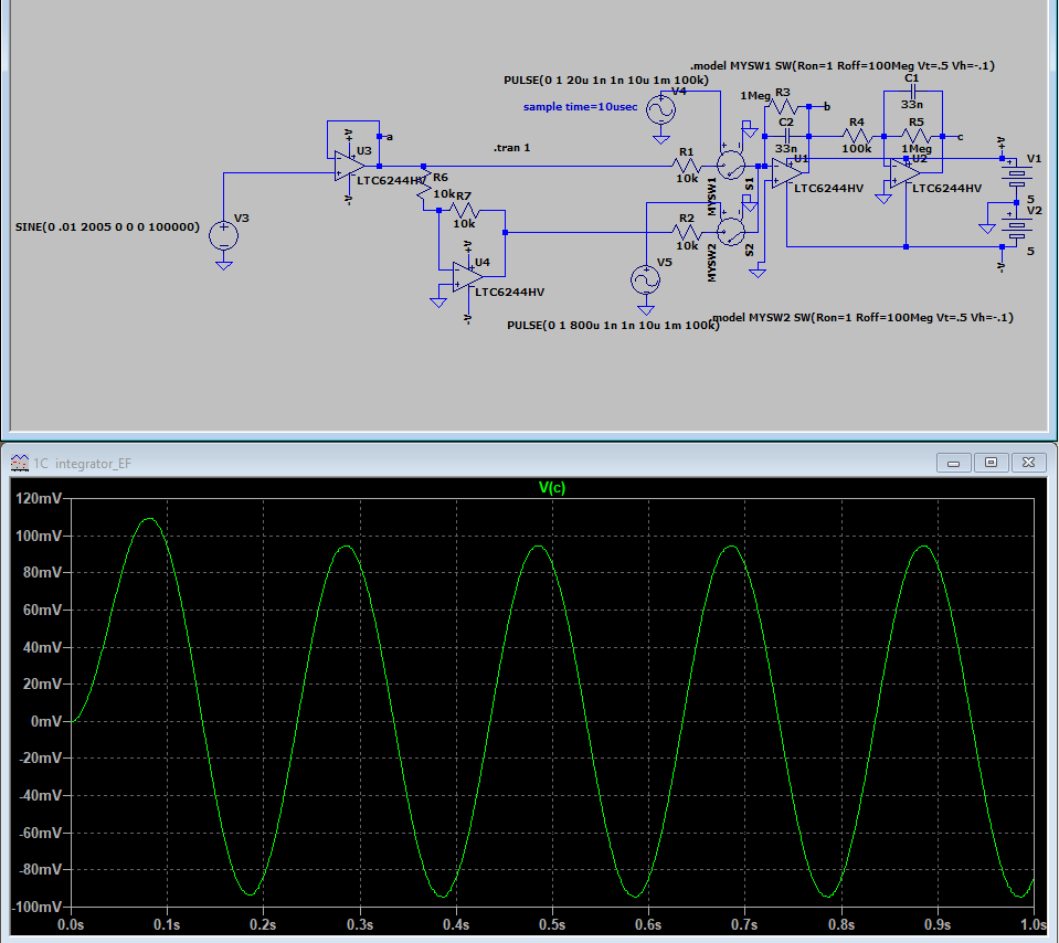

      I agree, the integrator and adding an inverted sample does a good job of cancelling noise below 1/2 the sample rate.The signal aliases near the sampling rate and above and doesn't cancel noise. Sample time does some filtering at high frequency.
      Including a spice sim. Change frequency V3 or sample time V4 and V5 to see effect. Maybe there is a better way?

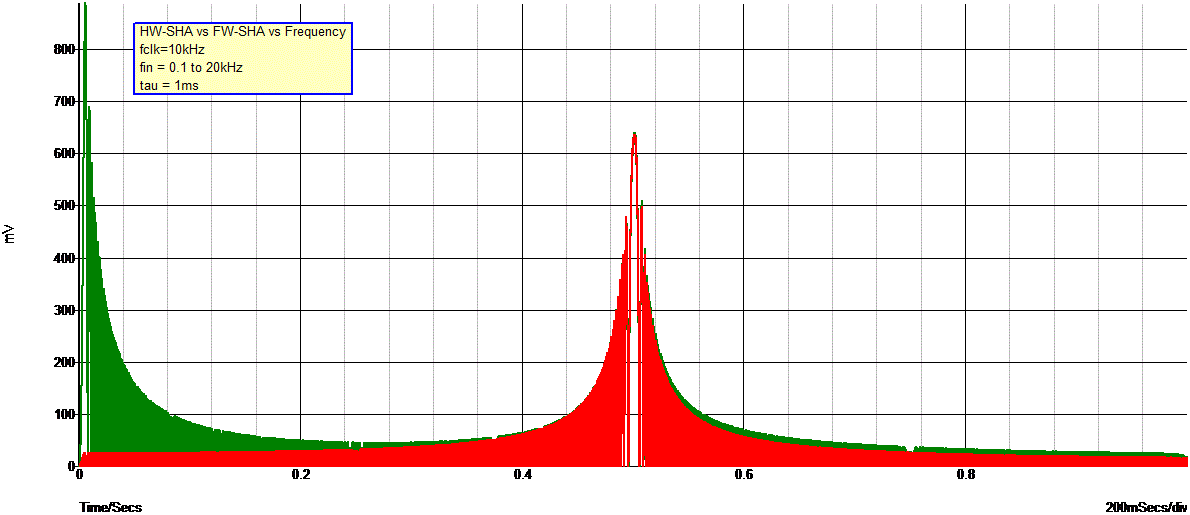

        Correct, an EF subtraction sample (or bipolar operation) largely cancels preamp flicker noise. Time-domain noise sims are difficult unless you have a simulator that specifically has that feature (aka periodic noise analysis) but I've found a trick that works pretty well. I use Easy-Spice (a variant of SIMetrix) which has a definable transfer function block; I use this to create a sinusoidal sweep generator and then do a (very time-consuming) time domain sim. A comparison of a half-wave demod (green) & full-wave demod (red) is shown in the attachment. These would correspond to "no EF sample" vs "EF sample."

          Probably looking at it wrong, why doesn't it alias at 20kHz?
            It's not a sampling circuit, it's an averaging (integration) circuit. So there is a null at 20kHz. Alias peaks are at 30k, 50k, etc.
              I have thought my circuit reply #3 simulates a normal PI integrator. Null or constant amplitude out at sample frequency and multiples of(1kHz in example). Aliases above 1/2 sample frequency, 995, 1005, 9995 and 10005Hz in = 5Hz out. Am I missing something?
              Trying to figure what your circuit is doing. What does fclk=10kHz mean? How does your circuit alias if it doesn't sample. Are you charting RMS amplitude out vs constant amplitude frequency in or something else?
                My sim is for a VLF-style demod, where the switches are 50% duty cycle. Therefore it is averaging all the time. fclk is the demod clock, output is the absolute value of the demod voltage which is why it is only positive. At fin=10kHz (synchronous) the peak is 0.636 volts, which is 2/PI, exactly as it should be.
                In your PI sim, you have discrete samples and (I believe) the spacing is going to affect the aliasing. I'd have to chew on that a bit to be sure.

                      Carl, thanks for the explanation (switch closed half the time). Was thinking should alias multiples of the sampling rate 10kHz. For 10kHz sample rate switch is closed for whole cycle at 20kHz in so cancels.
