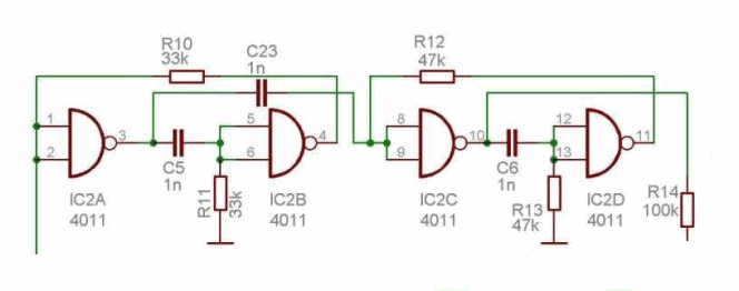

    I ask the professors to explain what formula they are counting on sample delay of 4011 or 4093 for pi detector

          If there is no formula then how do these resistances count?
          for example
            I'm not a professor but i have some practical work with CD4093.
            You must read a little bit about RC time constant, there are more information on the net and yotube also.
            In general T=RC but for ic such as CD4011 and CD4093 you must use some correction coefitient "k" - you can find and recheck them practically.
            Here are my example for CD4093:
            T=kRC
            k=0.85 C=0.001 R=51k
            0.85*0.001 uF*51k = 0.043 mS
            0.043*1000 = 43 uS

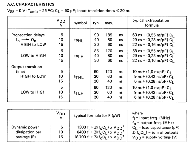

                    I found formula for 4093
                    I can not found for 4011
