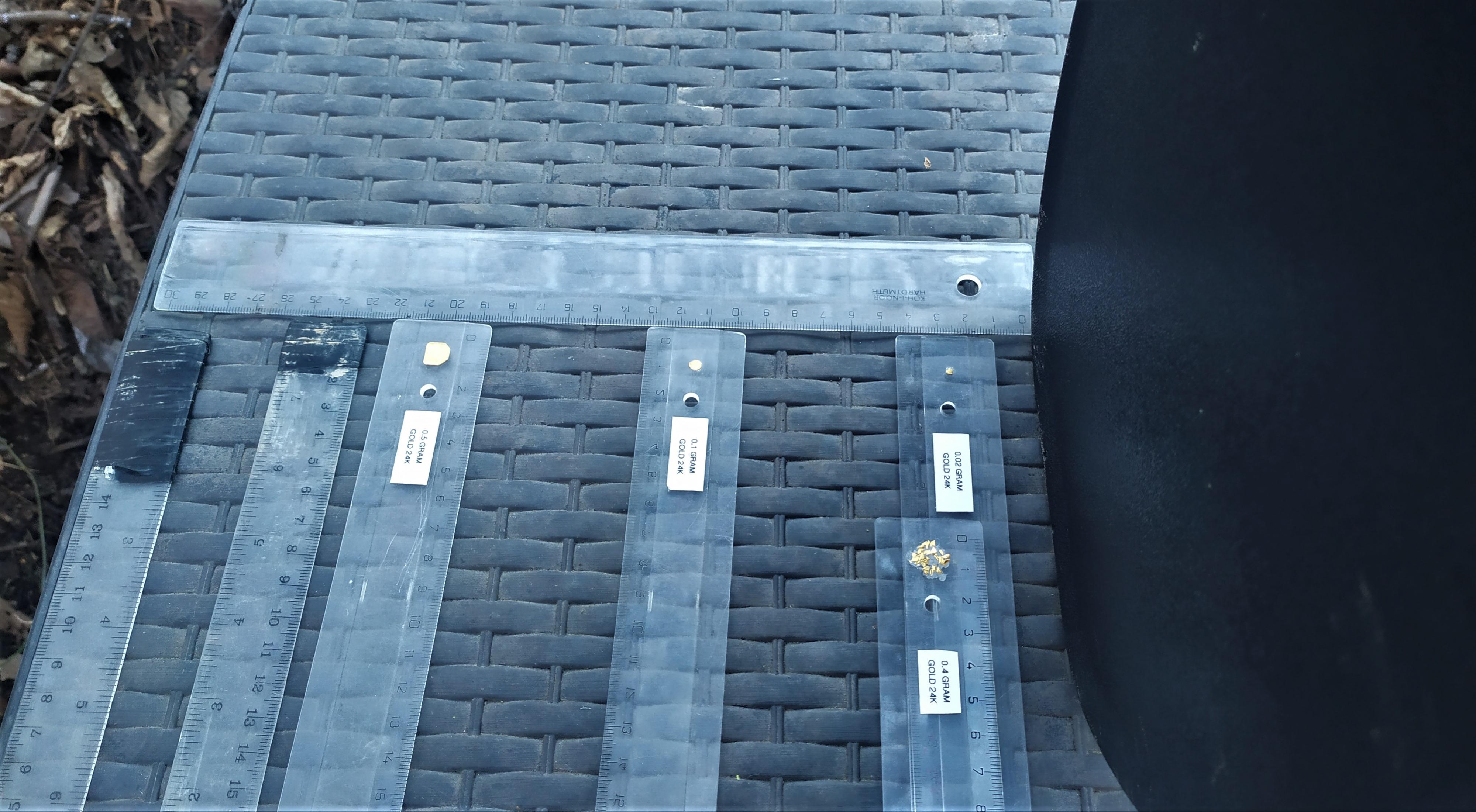

                      Here is a comparison of my ..Test ATX on some targets of different conductivity- among others even on a small 14mm -0.5 gram silver hammered .. the farthest target in the test ../ 28cm / ..
                      Maximum range at the highest sensitivity 13..on small14mm silver hammered coin will be somewhere on the border12 ".. maybe a little more ....
                      Garrett ATX set in this to a sensitivity of 10 .. .. / 13 is the maximum /, Disc 1, -what is the minimum value of the disc / is the delay /, Threshold 9,volume 13-max.
                      The ATX test is without Ground balance ...
