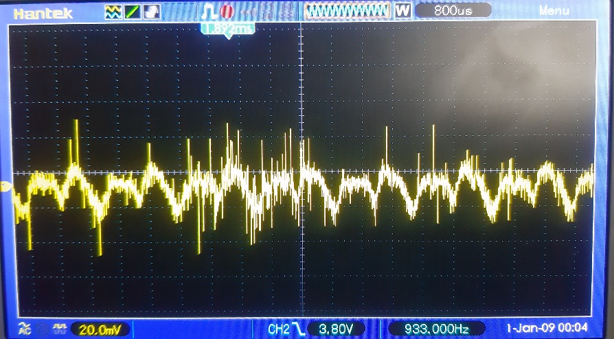

    EDIT: OMG this is what the 5V rail looks like with the coil removed! A hum of about 800 Hz. I'm using 8x AAA batteries.
    How can this be? Could it be an artifact of the oscope ground loop?
    The baseline at the output of the preamp (AC coupled to oscope). Tee regulator is U1 in the schematic https://www.geotech1.com/forums/show...213#post295213 (sheet 1 top right).

      Just saw your scope pics without coil and they do look pretty bad. I suspect there is not enough by-passing and/or bypass caps are not effective and/or
      PCB layout is not as good as it should be.
      Very possible the 5V regulators need better by-pass. I have seen some regulators do odd oscillations so recheck their data sheet carefully for recommended caps.
      Is this noise still there if you hold the Processor in RESET? If it goes away then it is generated by the processor.

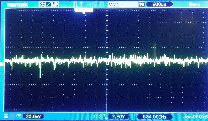

        You're right! According to the datasheet the LM1117 regulator needs a cap with ESR < .5 ohm. I've replaced C5 on the schematic by a 47 uF cap with 0.15 ESR and the picture improved dramatically.
        This is the 5V rail now.

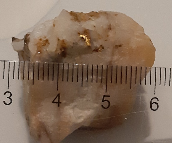

        Noise is down, I can halve the threshold. detection distance for the 0.75 g gold nugget has increased from 8.5cm to 10 cm.
        It can even see this small rock embedded gold at 4cm. Delay is 5.5us. Millimeter scale.
          Nice. Noise on scope so much better.
          That is very good sensitivity to the tiny fleck of gold.
          Are you still getting those random spikes or they they just much smaller.
            The spikes are still there.

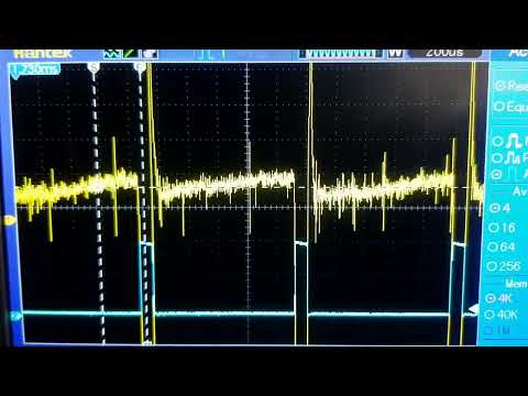

                One problem this design has is that the width of the Tx pulse flickers +-200ns. The sampling delay is timed by the MCU precisely at 6.5us after the falling edge, +- 65.5 ns which is the lock cycle. However, the amplitude of the Rx signal varies accordingly. If the flicker followed a gaussian distribution then oversampling would cancel out the signal changes but if it has a 1/f distribution then it turns into low frequency noise.
                One remedy is to replace the U5.A op-amp by a fast comparator. My next version will use an LM311 which has about 200ns rise/fall time. The op-amp I'm using (LM6172) has 2.5 us instead.

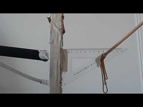

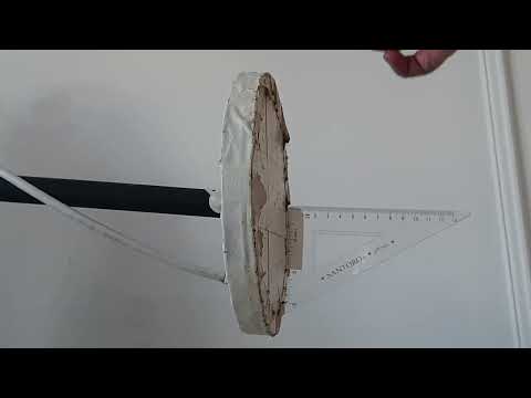

                I just uploaded this video showing how this PI reacts to a gold chain.
                  Iron discrimination of a bottle cap.
