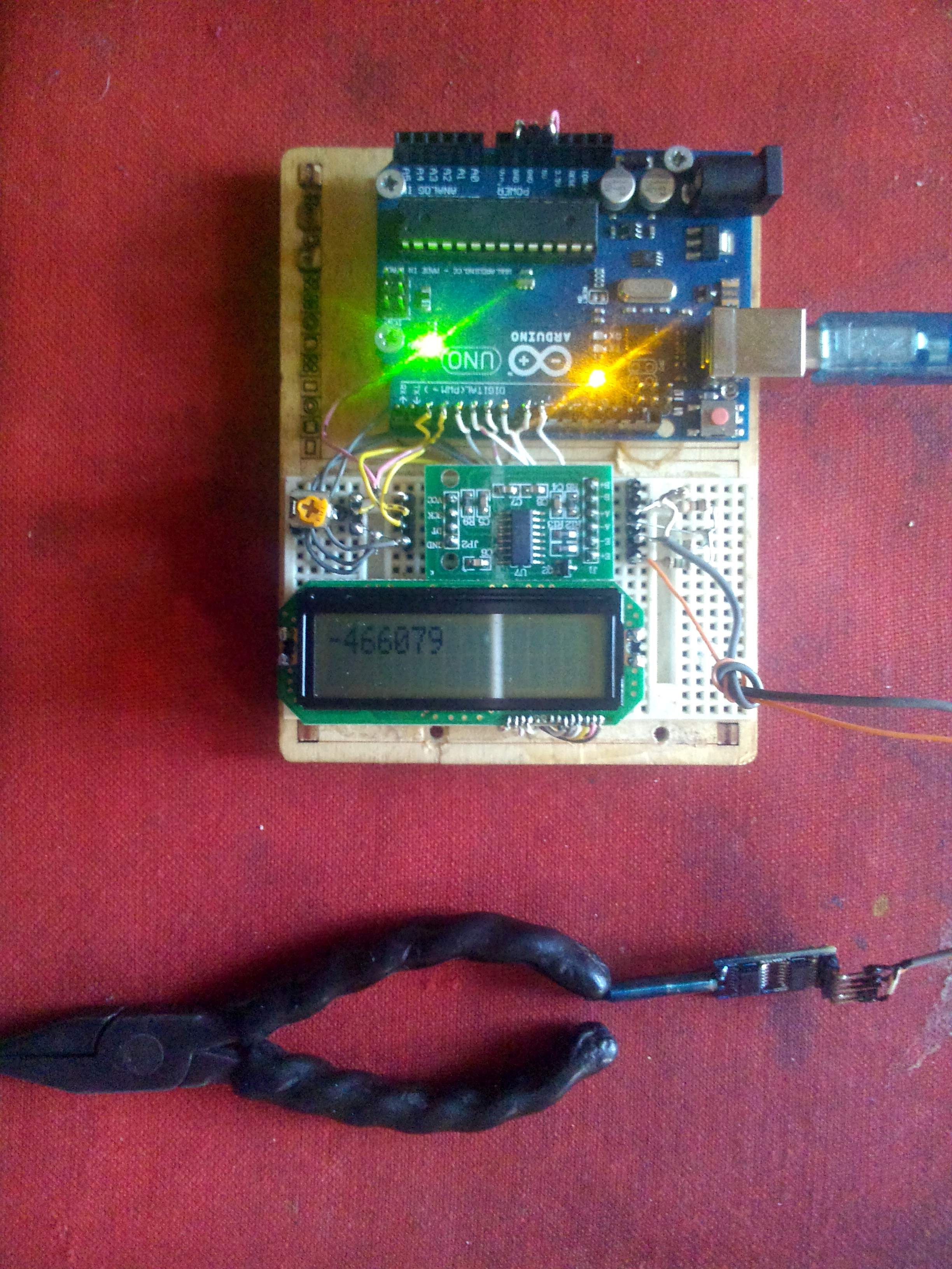

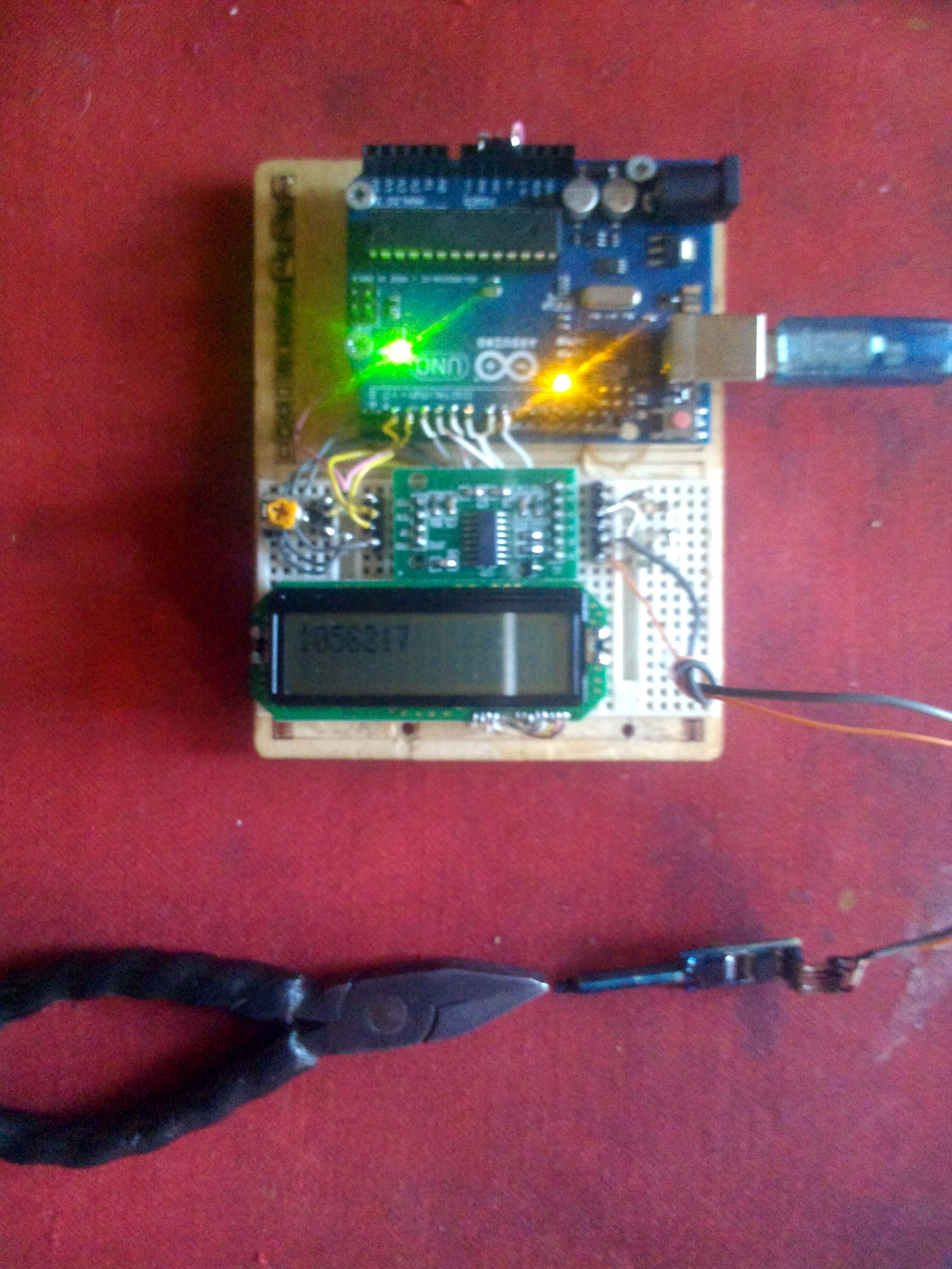

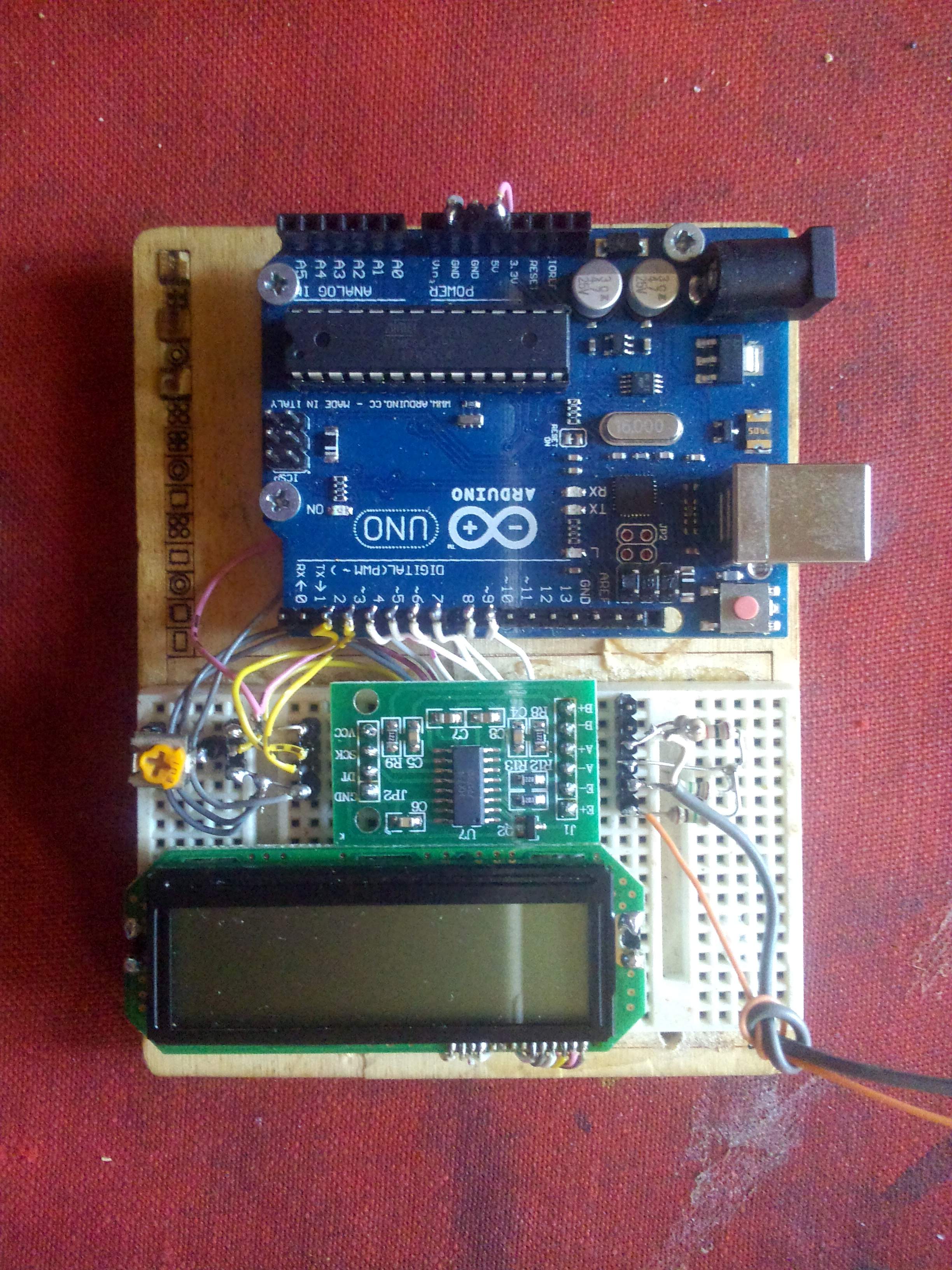

    True 24 bits with Atmega328P?? Yes it is possible!
    For not speed-demanding-sampling-rate applications (what a weird sentence!?), 10 to 80sps; here is proven neat solution with cheap and affordable HX711 modules:
    (thanks to existing libraries all this becomes a very easy play)

    10 samples average.
    I purposely added LCD to check overall behavior when rising the averaging number of samples.
    Up to 30 samples is not significantly affecting the LCD behavior. Yet; everything above 20 is not providing me importantly more stable readings.

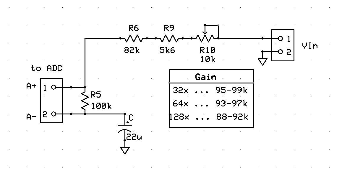

    Adjustable gain:

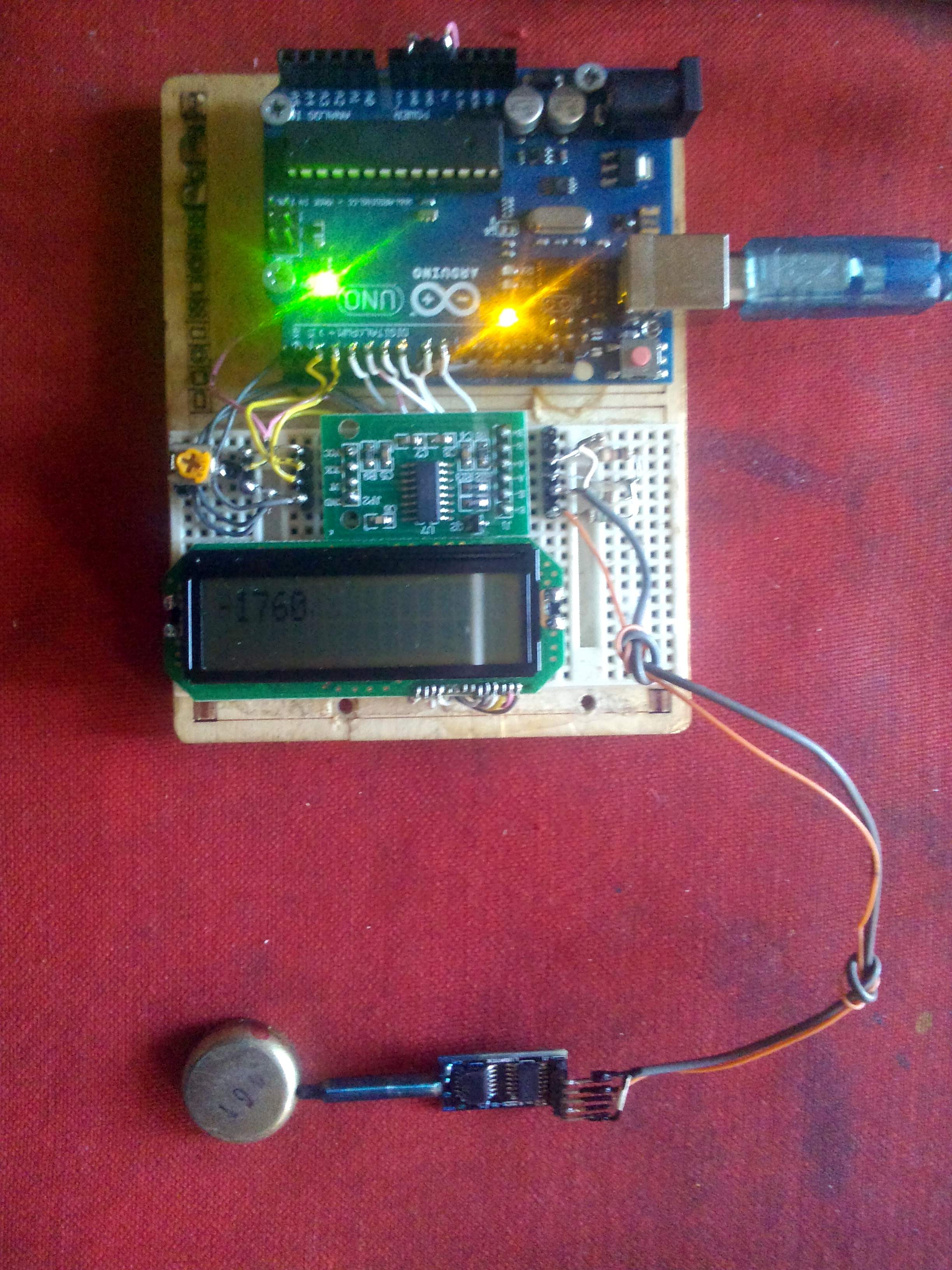

    In exact primer; measuring the FLC100 sensor voltage swing (as i recall correctly, 1.9v to almost 4v, extremes though) i got resolution with range roughly 0-14 000 000 !!!
    Ain't that enough?

              0- 2.5v -5v
              I can't tell for sure.
              In room conditions, placed on workbench; i got approx 1.9-4v swing.
              All the possible noise from such environment is probably affecting the range.
              Even such; is far above than enough from what i needed in experiments with 24 bit ADC.

                      This provoked me to think more about the whole thing.
                      Actually i am having couple of EMS100 sensors and not original FLC100.
                      It was buried in my mind as "FLC100" because i saw so many claims that actual EMS100 is exact copy of FLC100.
                      On some forums there are claims that EMS100 is even "better and improved" copy of FLC100!?
                      Now we have pretty important issue which probably denies such claims.
                      No matter what i do; i can provoke 1.9 to 4v swing at most, at this sensor.
                      This is interesting to keep in mind.
                        Ain't that enough?
                        Also there is another thing here that must be corrected. Since i did this for quite a while ago; i forgot the details. Later on i make mistakes like this.
                        I got resolution up to 1 400 000 and not "14 millions" like stated above.
                        1.4 million in positive values and not exactly sure about the end extreme in negative values.
                        But certainly, even like this; i got much more resolution than i needed for given application.
                        So, HX711 attempt is total success. Of course, depending on what's your final goal with it.
