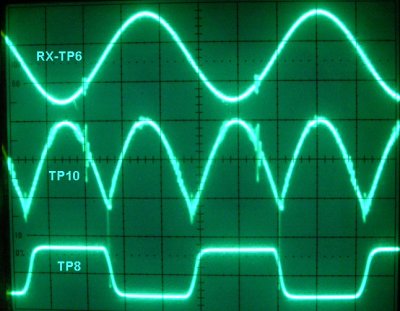

                          Is this really Full wave Demod?

                            Hi, I made some changes, please see updated data : http://www.hq-elektronic.eu/menu_sab2_vp.html
                            Full wave detector can eliminate all stochastic-random noise. You can testing detector and watch CRT TV, there is no interferences. With half-wave it is impossible.
                            Next picture - there is a RX signal (200mV pp), "detected" signal and "driving" signal from comparator to 4066. TX signal is 40V pp, gain of preamp is 100, so rest signal on RX coil is about 2mV from 40V. There is no problem with TX to RX breakthrough, but better is use external RX pre-amp.
                            Yes, there is some noise over RX signal, but this is HF noise and static, so can be easy filtered. You can try different OP amps, I was made some tests of it without any distinct change of depth. My most important thing is good stability and easy production.
                            TP8 is measured with uncompensated probe.
                              Very interesting improvement Zdenek. What mean "external RX pre-amp". Preamp build in coil?
