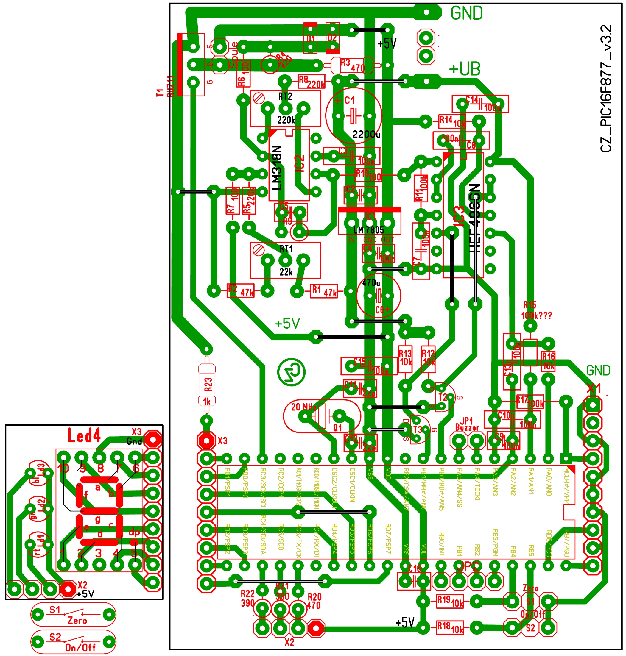

      Here my new Layout. I hope, now all mistakes deleted...
Name:	CZ_PIC 16F877_v3.gif
        Originally posted by württemberger View Post
        @ Walkman
        [ATTACH]27651[/ATTACH]
        You're right. I now see. I am forget R4 resistor.Thanks

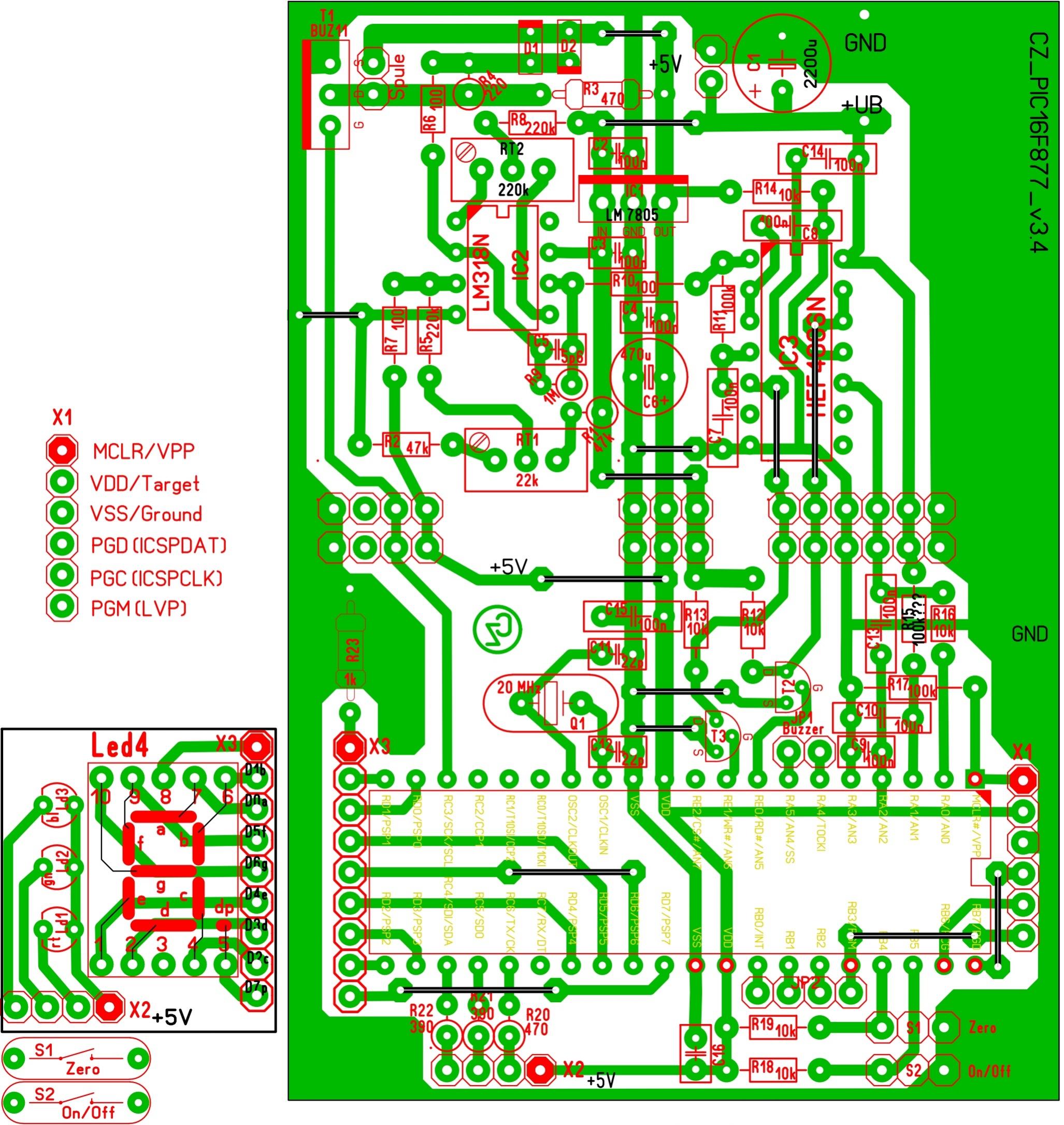

          Here a Layout for a Double-Side PCB

                    hello jim,
                    please write a p.m. to württemberger
                    he has improved the layout and has changed the sourcecode already
                    so if you give him your e-mail, so i hope, he will send you the files
