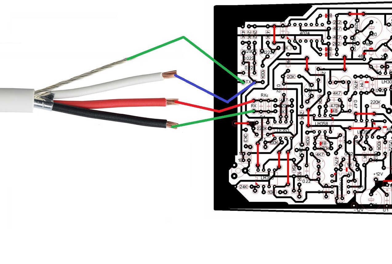

    Hi cdi! Can you post a photo of your board maybe we can spot the problem there..many eyes is better then two i also suffer that problem too and it just the orientation of the transistors near bd140.

      this error is i have fix just check your wire use all copper wire then check you connection from board to pot the P10 P20 P30 then K1 K2 K3 then the coil replace the TX To RX try that

            you will, just make sure you connection is good and use 4 wire connection with shield for coil

              Today i spoted my transistors are not 2n2222 and 2n2907, they are named CTPN2222 and CTPN 2907, in schematic they are named 2n2222 only. What i need, NPN or PNP?
                Transistors are ok (NPN and PNP), but you need to check legs orientation, this could be different, depend on producer.
                  Atlast i solve the beeping problem of my tgsl.. it just happen that the pigtail of rx coil was break..and the j103 transistor that i replace to my old ksp246 (bf 247 from the schematic) which i thought better was one of the culprits..

                    Can somebody give me picture how to wire pots? Maybe is my mistake there...
