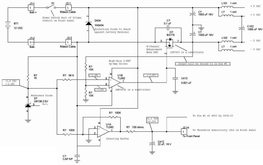

      Then a friend of mine brought me a sovereign gt posed running, but no part more contacts all clean integrated .that he jumped. lt O62 lm or 2931 thanks
        hi I have a sovereign gt that will not turn already replaced the tl 062 lm and 2931. but not the part where I can watch
          foto
          I then measured on L102 and L101 instead of having 5 volts I have 10 volts ..
            a schematic of XS XS2 is not fitted Elite one. you have LM2931 and you have to see +10V on its output.
              Yes 10volt
                hello i have 10 volt output ... but do not sound
                  then changed the subject to the integrated metal is the same .. I turn it on and then you immediately feel laudio off .. I remove the red diode with gray band and side and hear the pot,, the diode and as good as we put it back goes out, where I have to see some transistors smd ... this diode do not even know the number,, however, and red and gray band, and is connected together with a transistor smd.marcato + 813th in both
                    hello kat I'm sorry I do not have 10v out in what I have to check
                      No. Treashold

                        Failing that PM me I have the schematic
                          and it burned again integrated m74hc00. and tel 062
                            hello I look forward to the scheme through
