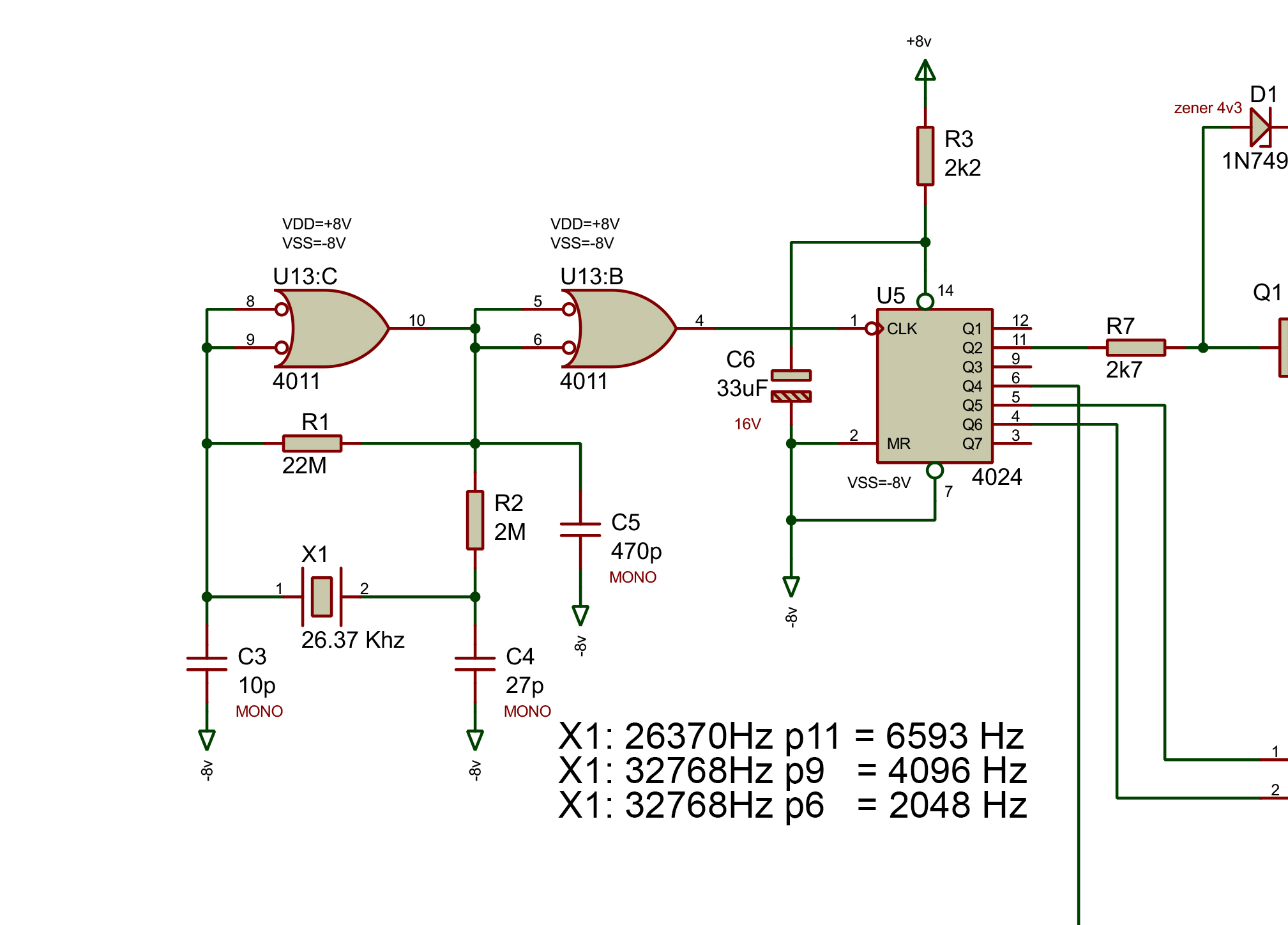

    I can not find 26370 xtal.
    Does anyone know if these variations might work?

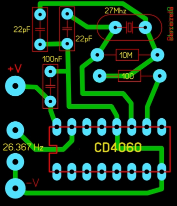

    you do not find out it just rare type. try the way -
    1- simple pic or avr generator based on.
    2 - something from 420 khz ceramic quartzs that used in tv remote control pults. plus divider on 4060.
    420000/2/2/2/... = 26250
      4060 its my second option 27mhz / 1024 = 26367Hz (nearly 26370)
      26367 / 4 = 6591.75 Hz for coil its the same
        i did not suggest mHz range - it wastes energy on every stage of divide.

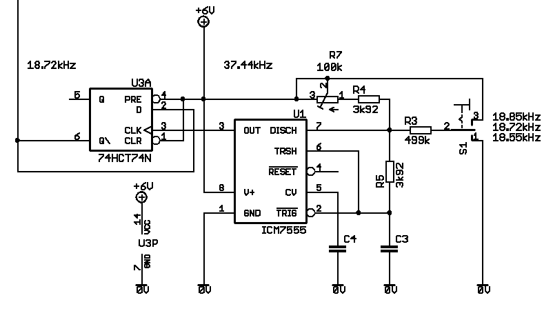

        take a generator on TLS555. it is good way.

              The 16 Volt power rail is something that you have to consider. 15 Volts is a common max quoted in datasheets for some 555 variants.
              If you want alternative crystal / divider replacements, here's a couple:
              4.194304 MHz divide by 32, divide by 5 = 26212 Hz ( 0.6% error)
              4.433619 MHz divide by 8, divide by 7, divide by 3 = 26390 Hz (0.07% error)
              Both these crystals are common and dirt cheap: (binary divider, & colour TV sub-carrier)

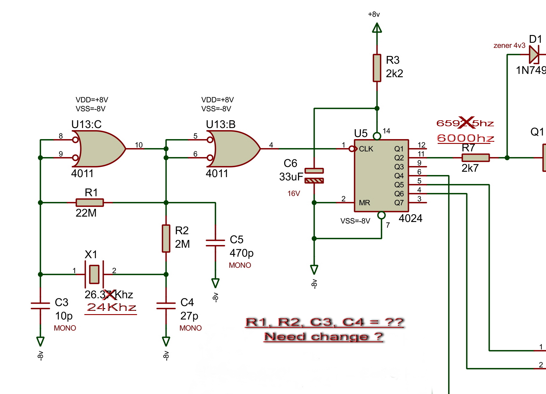

                    Change xtal 26370Hz / 4 = F 6592,5Hz
                    xtal 24000Hz / 4 = 6000Hz (Coils TX: L=570uH C= 1.23uF ; RX: L=17.9mH C= 39,31nF )
                    ¿ is need to change something more in the circuit ?
                      choice right r c values

                        correct?
                          Or R1, R2, C3, C4 in 4011 circuit ?
                            in THE generator on ne555 i did put above. you have to tune it on 26370.
                              I don't like the choice of 555, my question is:
                              ¿Is not easier to change the xtal 26.37khz to 24kHz and adapt coils for 6000Hz ?
                              thx
