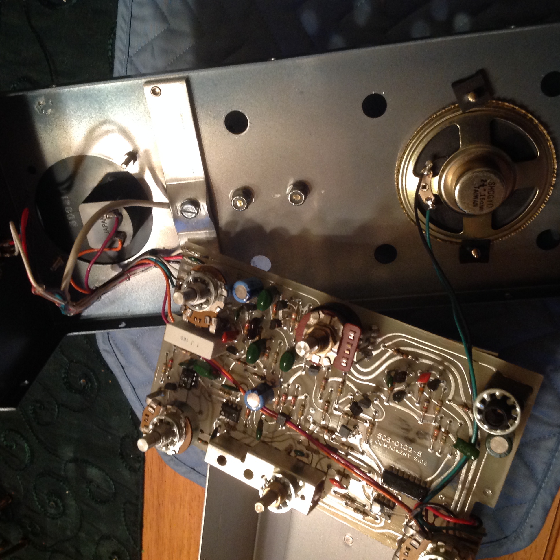

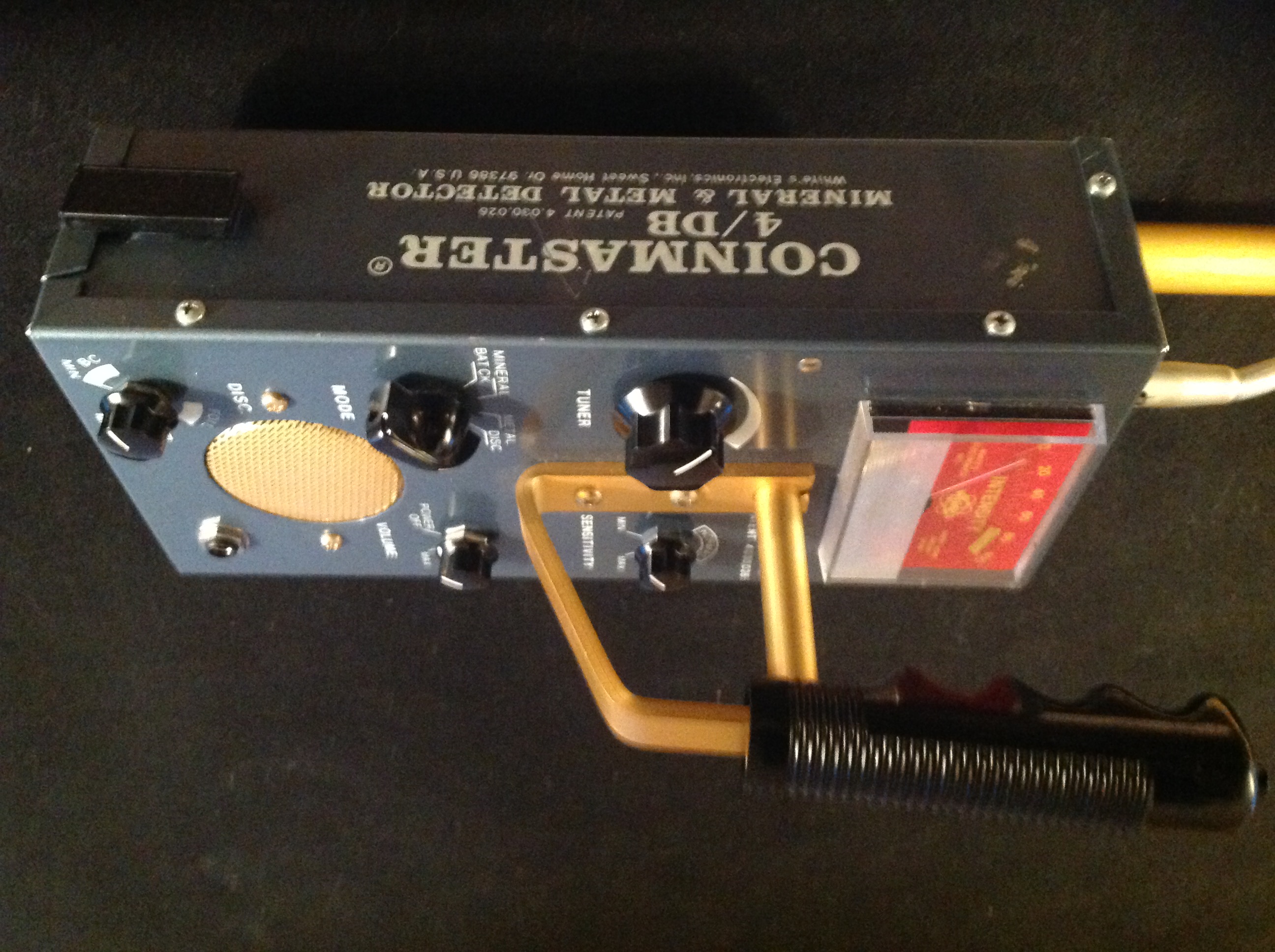

    Hi All I'm looking for a whites Coinmaster 4 DB schematic. It doesn't make a sound the meter pegs out when turned on
    it doesn't look like it's ever been used. I'd like a road to the circuit before I open it up any help would be greatly appreciated

          Thanks again for the schematics I just wanted to follow up on my findings.The detector as I said is in like new condition I opened it up and the inside is supreme so before I started poking around I remembered I never plugged in headphones so I tried my phones out and it
          functioned perfectly. I field tested it and it worked as great as this old beast can so I don't know why it's not working without the headphones but I don't detect without them

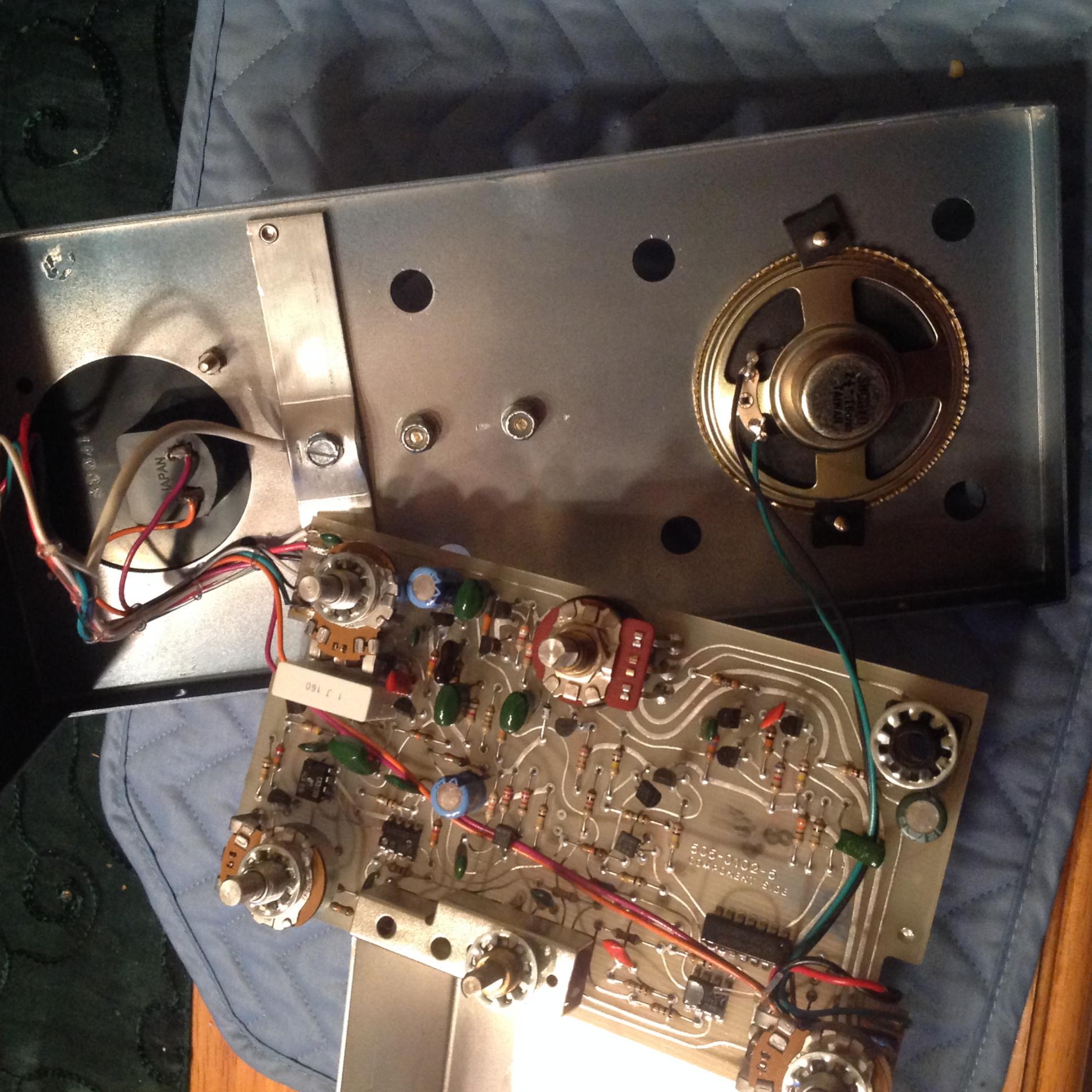

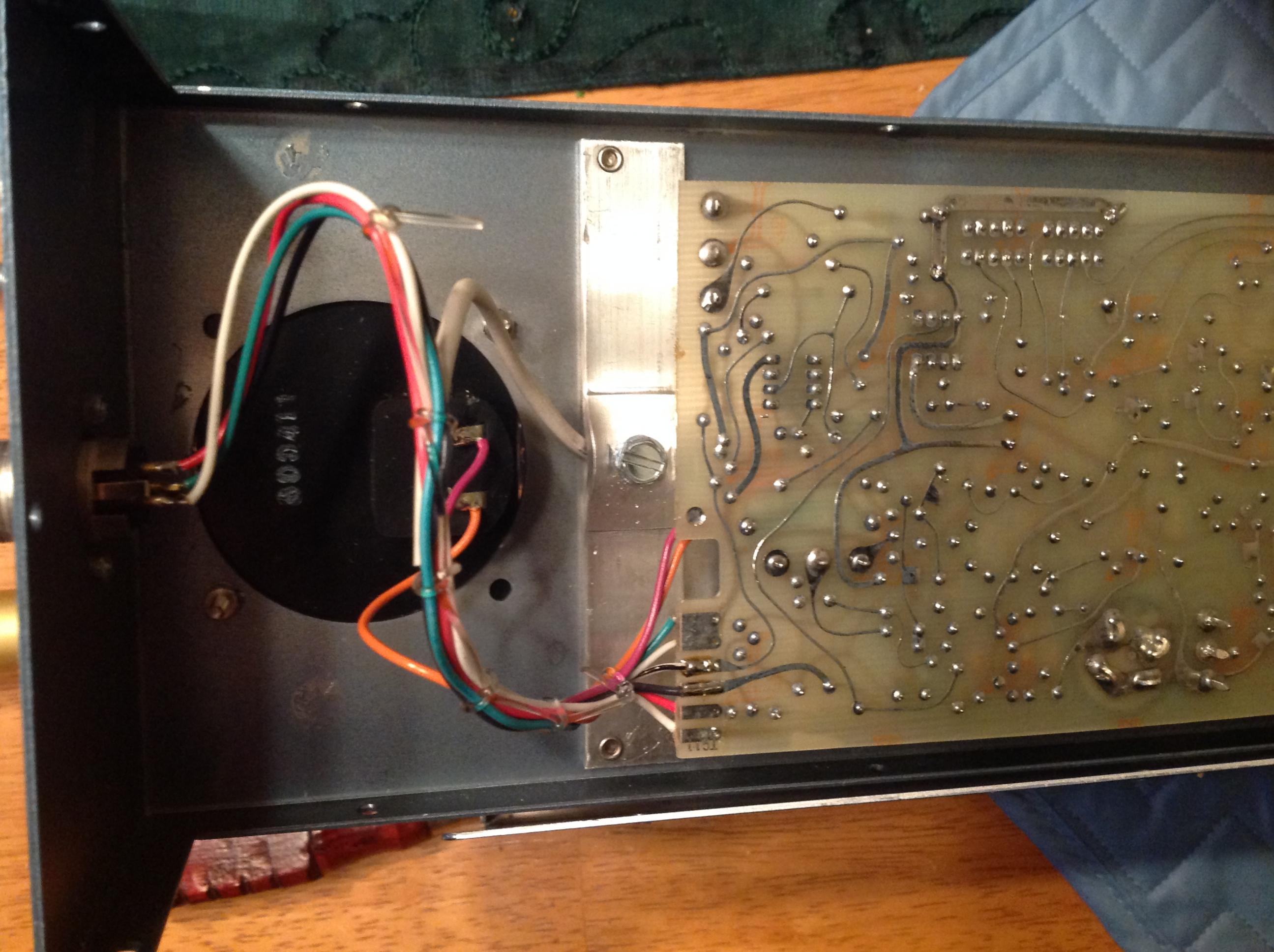

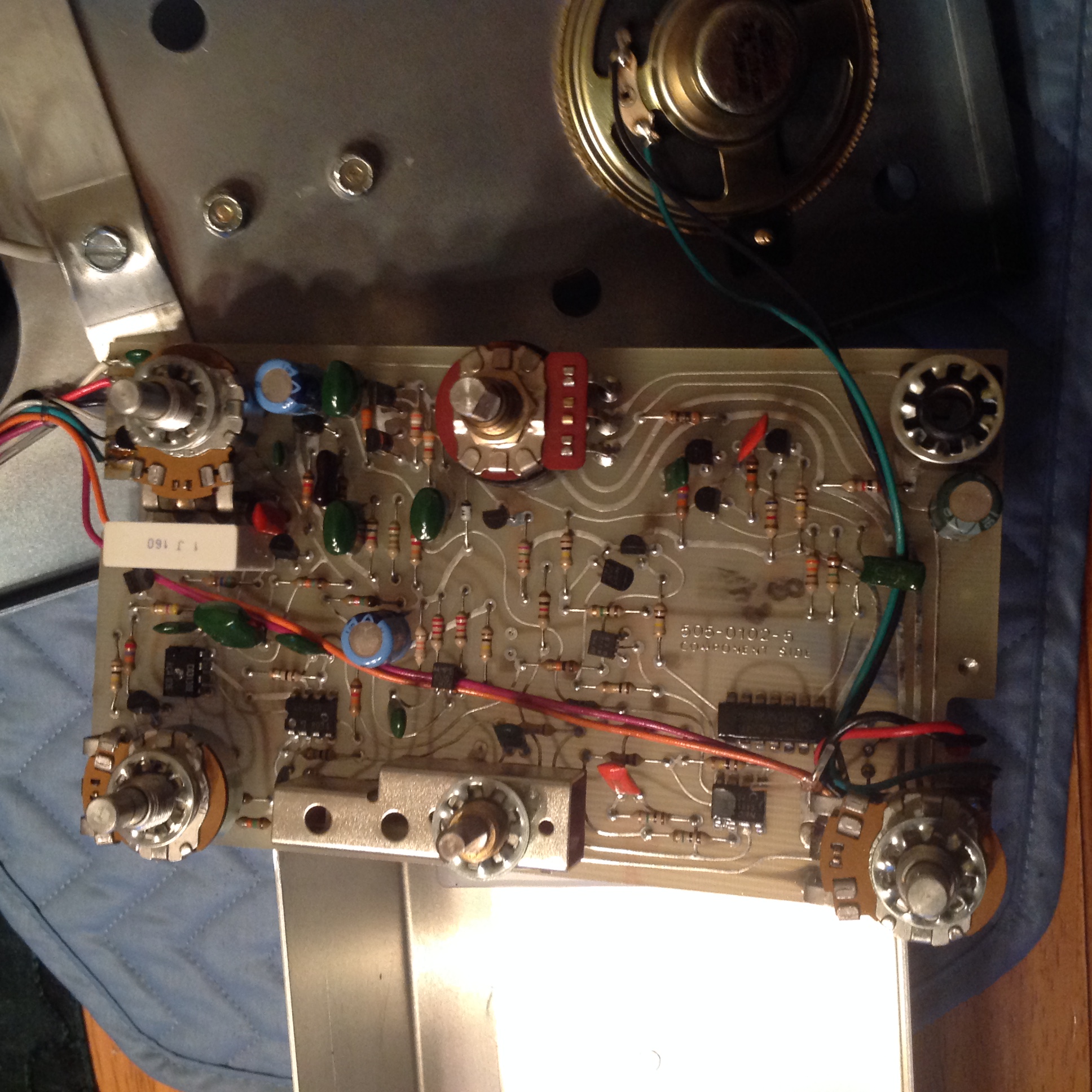

            Bad speaker maybe? Or loose/broken wire to speaker? Or maybe the jack itself is corroded on the inside. Spray/clean the headphone jack on the detector. How about some pics of the inside?
              Ok I'll shoot some when I get home from work
                Here are the pics: Click image for larger version

                  Nice, one of the chips looks like a huge chunk of it broke off. or is that just some paint or something, anyway the thing works except for speaker.
                    That is a reflection on the chip the whole board has a glossy coating on it which makes very shiny probably for moisture resistance.The machine works perfectly with the headphone jack is in take it out and it's dead silent and the meter pegs out.Very strange but like I said I always use headphones anyway, but it bugs me when things don't function perfectly.
