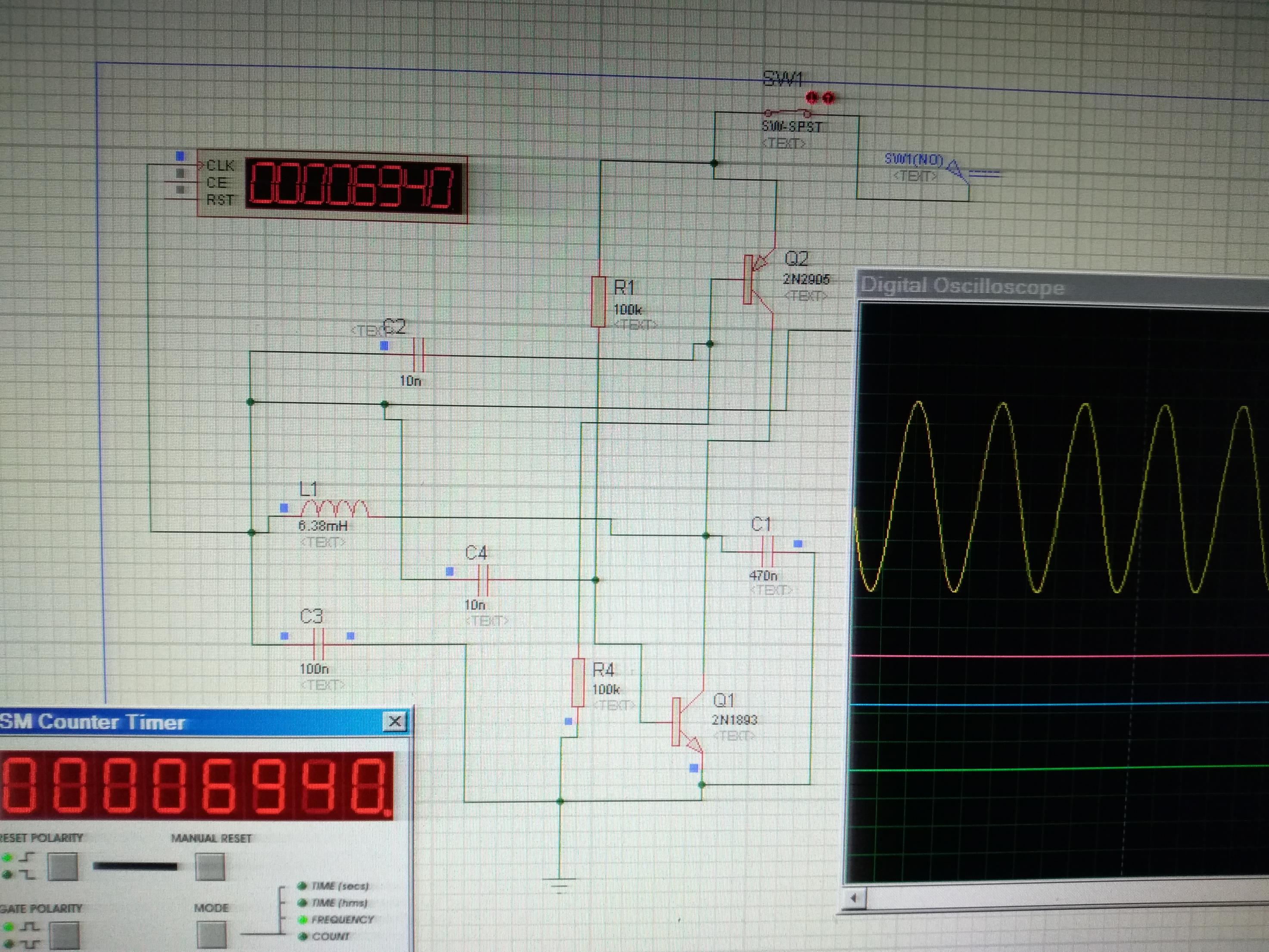

    Not more powerful,Q factor is very high.
    The current at the coil is 2,5 times higher for the same battery voltage. The magnitude the magnetic field is proportional to the coil current. This oscillator goes deeper, uses less components and the transistors don't degrade by high reverse Vbe voltages.
      Transistors works in grounded colector schematic. R input is high. Reversive voltage in transistors is high.
        The plot V(b,e) proves otherwise. Max. reverse Vbe is -0.9V for Q1 and 1V for Q2. Compare that to -20V in your design, not reliable. When your oscillator stops working now you know what happend.
          Simulation of your circuit does not work on program proteus. It works this. Click image for larger version

            You'll do well to take the soldering iron and see how your circuit actually works. Then write.
              Reverse Vbe works mostly as a Zenner diode, and they'll be fine unless the current is too high. Horizontal deflection transistors did that all the time... and often released the magick white smoke.
