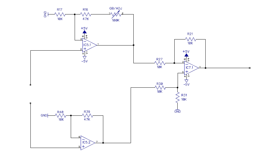

    does anyone have a ground balance schematic for pi
    Many in this forum.
    First check the TDI schematic.
    Then there are mods for the MPP and maybe the Surf PI.
    Last is the firmware approach I used in my HH2. Easiest if all timing is done with a ucontroller but could be done with hardware timing (just messy).
      is there no separate schematic specifically pi? because I modified pi polones in the frequency section to be sensitive to gold, and the results are satisfactory, I just need to add GB for my device
        As I posted, there are many GB schematics and methods in the forums here.
        Is the PI Polones circuit ucomtroller based?
        If so then check my HH2 thread on the 3-sample GB method.
        The other common method is another integrator and two more sampling switches to create a GB 'channel'.
        This is then subtracted from the 'main' detection' channel. TDI, SD2000, etc use this method.

                No this is just answer to the question of the topic (just a regular TDI/GoldScan ground balance with manual adjustment).
                I'm curious about doing auto GB and I don't see this being discussed anywhere.
                  You can use this circuit - just add 2 more delayed samples (GB1/GB2) to your regular circuit (MPP for example). op amp 5.2 is your regular intergrator (s1/s2); and op amp 5.1 is going to be connected to the delay samples integrator (GB).
                  GB1 = 10us after S1
                  GB2 = 10us after S2

                            can auto zero using ic lm13600 on sd2000 be applied to the pi scheme ?? I am still formulating the scheme!
                              The LM13600 in the SD2000 is for the audio circuit and not related to the ground balance. Look in the previous stages how the GB is done, right before the channel selector switch, but if you are talking about absolute value audio circuit then perhaps you can use ideas from this audio to apply it to your design.
