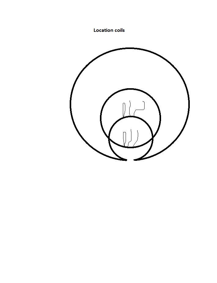

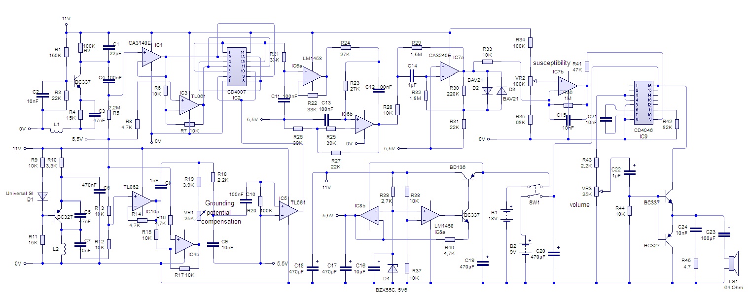

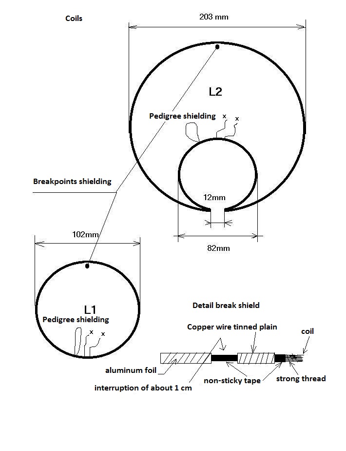

has anyone ever tried this schematic..and what kind of detector is this .. ??
  • has anyone ever tried this schematic..and what kind of detector is this .. ??
    I just want to share what I have. and planning to make it. and i am in the learning stage, so please don't ask me about anything difficult, .. please understand,.. scheme from the YouTube channel owner

    It looks like a VLF IB detector but I could be wrong.
      what are the advantages of a VLF IB detector ... because I live in the country of Indonesia with land that does not contain much iron and maybe worth using here
        Good afternoon. It looks like a modernized Magnum. Give a link to the source of your circuit.
          I got a scheme from the YouTube channel owner via email the link is in post 1 ,. my friend drew a pcb layout and have never tried it, .. maybe there is an error I do not know ,. and I'm still confused about using the diforum menu how to reply to comments included files, ..?
            go in a section of the site PROJECT. seek out there MAGNUM IB DETECTOR.
            it is your. just VCO part changed on 4046. nothing new. the oldie flashback/concept.
