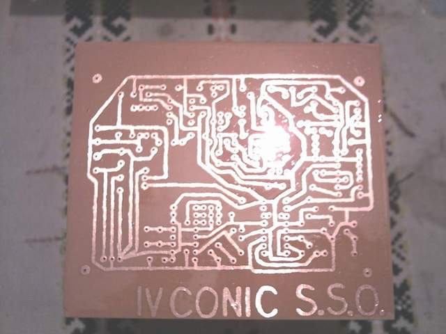

                          pcb
                          here is a handmade pcb....
                              Wow! I can't believe you made this by hand! Great job!
                              Don't forget to install the three jumpers first. lay them flat.
                              If you need any help in getting parts, or adjusting it, let me know.
