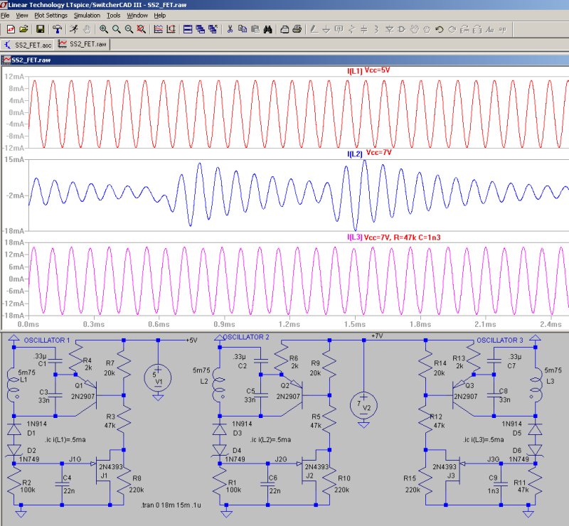

                TXP - I wish you were right but your modification idea may not be so straight-forward as it would seem. The FET gate circuit could be a source of amplitude instability if not tailored correctly.
                The top trace shows iL1 nice and stable. This uses the "original" SS2 values as shown in Merc's schematic.The middle trace shows iL2 hunting for equilibrium. The two circuits are the same except for a 7V supply voltage for oscillator 2.
                I played with the RC network to obtain amplitude stability in oscillator #3. Notice the hugely different RC values. On close inspection, see that oscillator #3 amplitude is not really stable, but is quivering.
                1.2nF, instead of 1.3nF could make the difference. I derived the circuit empirically - through trial and error. I have no formula to make things work.
                I know this is only a computer simulation but it is cause to be wary. You don't get something for nothing. As a disclaimer, or to add to the confusion: Golden Sabre and Eldorado circuits, operating at 14kHz and 10kHz, respectively, both exhibit the same anomalous behavior shown in the middle trace when I simulate them with component values supplied with reverse engineered schematics from this website.
                I'm not saying this is what will happen, I am showing what could happen. I guess it could be said that computer simulation is a poor substitute for the real thing, but until I can set up an oscilloscope - it's all I got, and I'm being wary.

                    Merc, Your schematic looks fine. I was showing what might happen when somebody tries to get more power out of Tesoro's "oscillator with FET amplitude stabilization" by connecting directly to the battery, but neglects to make corrections to the FET circuit. It makes sense when I think about it, but I can't define the behavior.
                    What's really confusing, and I wish I had a real lab: when I simulate Eldorado and Golden Sabre - I must make changes. All other things being the same, I cannot successfully use the same FET gate RC values shown on those schematics and obtain an amplitude stable signal. There is probably some unknown quantity at work in the real world that I am unaware of, (obviously, but I mean, besides the ones that I can IGNORE) not being represented in my spice circuit, and it's trouble in my virtual lab. So, I change the RC value and flip the switch again to move on. Inaccurate maybe, but fast.
                    In contrast, when I simulate your circuit, it works fine in original form. Smooth as a baby's behind. However, and as should be expected, when I raise VCC to or above 5.8V (as would happen with TXP's suggestion) amplitude goes crazy. The middle trace in my LTspice screenshot shows your SS2 but with VCC=7V instead of VCC=5V. Simulations suck, but there it is.

                        Hi porkluvr,
                        One thing that can upset SPICE when simulating an autonomous circuit, is the ideal nature of the inductor. Have you tried inserting a resistor in series with the coil to include the DC resistance?
                        You'll probably find that this has quite a large effect on the operation of the circuit.
                        I'll try this myself sometime this weekend. Too tired at the moment...

                          Well, Qiaozhi, everybody,
                          It's embarrasing to have to admit I made a mistake, but adding parallel resistance (in addition to the 22Ω series resistance and 987 pf capacitance I already had) will make the Golden Sabre and Eldorado oscillator circuits simulate without exhibiting horrendous amplitude instability. I see that cable RCL between search head and transistor should be figured in.
                          My models are vastly over-simplified fakes and sometimes it really shows.
                          So, what this suggests, is that there might not be such a horrible price to pay for tapping directly off the 9V battery for the transmitter... .
