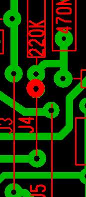

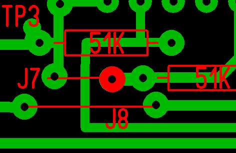

        Hallo Nelson, I use RG 58 and normal cable, there are not difference of results in my home experiment in the old version of the circuit that you know.
        Next days i finish mounting the new pcb, today i have mounting the resistors and same capacitors, there are same mistrake in the new pcb. Add two pad for J7 bridge and J4 bridge.

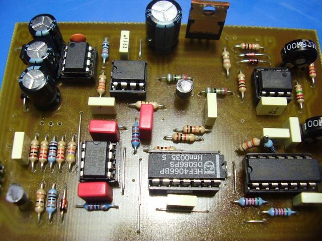

            • I have assembled detector by using oxygeno07 layout. It works!!!
              Not so good as I was expected, but works. 26 cm for 1 euro coin in air. (Not a loud and clear but makes a signals). 22 cm loud and clear.
              1. First, I have found and fixed mistake with placement Q6 (BC337) in oxygeno07 layout.
              2. I have used twisted pair to connect coil. !!! IT WAS WRONG !!! Once I have wires untwisted sensitivity has doubled.
              I think capacitance of twisted pair or RG58 coaxial cable may interfere. I expect better results with RG6 coaxial or even flat electric power cabele (not twisted).
              3. I have replaced C9 1000pF with 470pF. Look like more convenient for range of pot P3.
              I have tested two coils: 24 cm, 21 turn, 0.41 mm and 25 cm, 19 turn, 0.6 mm. Both make similar results.
              Second coil with 0.6 mm wire makes little increace in power consuming 5 -10 mA. And may be 1 cm in sensitivity. Both coils are flat (spiral).
              My device consuming 50 mA electric current from the batteries. WHAT IS YOUR RESULTS FOR CURRENT?
              I have checked that 25 mA is for schematic and 25 mA used by coil because all consumption remains only 25 mA when 555 generator is off. (no impulses to the coil)
