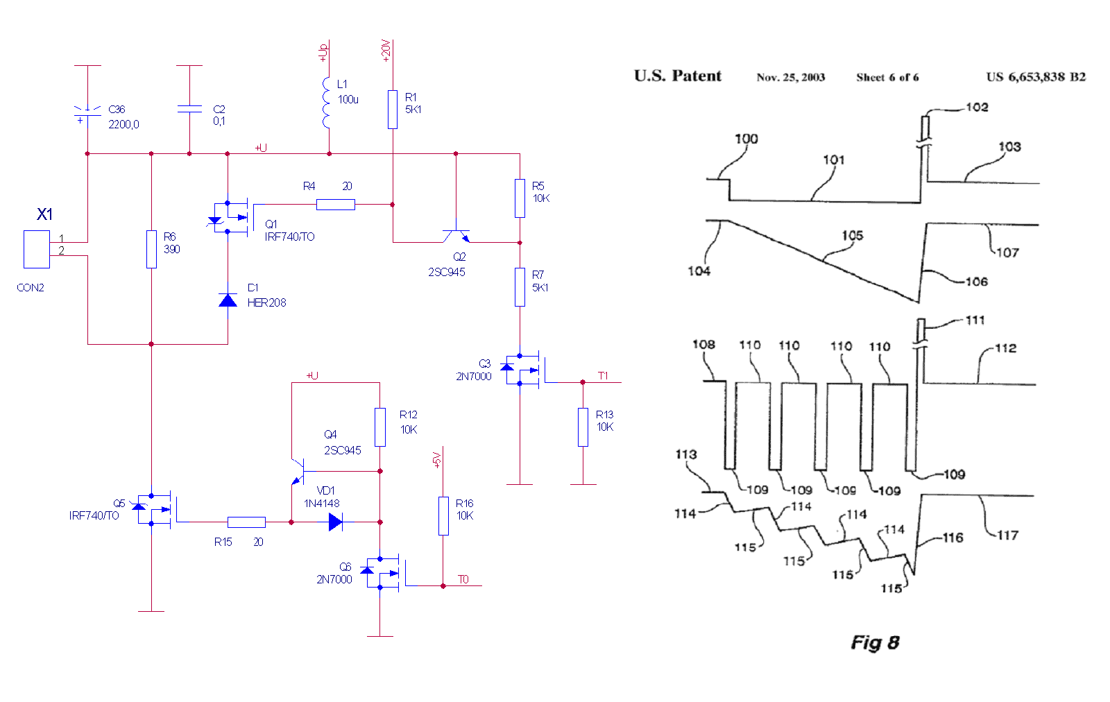

    Hi to All ,I need Pulse İnd. Discrimination schematic or with full Hex software MD . (Without Surfmaster schematic).
    http://fandy.front.ru/Chance.htm
    Schematics & PCB - http://fandy.front.ru/Chance.pdf
    Full hex - http://fandy.front.ru/Chance_04.zip
    Coil parametres are critical - L = 400 uH, R = 1,7 Ohm, design (of coil) in a photo.
    Now the device passes tests. As a whole results is positive.

            Hi Andy_F ,
            Can you tell me about use of 7660 in the circuit.
            how to control 7660, does 1 hold signal of chip , after TX off , enough for whole RX signal's pass thorugh opamp? to charge caps?
            how many hold on signals do I need or how long ? 2us , 5us ?
            can you tell me how to control this unit by chip , I want to try circuit by PIC
            kind regards
            Okantex

                what about your sampling time , what is it by using MCP3200 ?
                in mcp 3200 you can not control S&H cap value , so you can not decrease it , is increasing V of opamp enough to feed S&H cap ,
                I wonder your sampling time in us s .
                to fill 20pf cap you must need more than 10us , am I right?
                kind regards
                Okantex

                  I wonder your sampling time in us s . to fill 20pf cap you must need more than 10us , am I right?
                  Surprisingly, but sampling time ("Analog input simple time") also is specified in datasheet of MCP320x . For clock frequency 1 MHz this time is 1,5 uS.
                    Hi Andy ,
                    yes I read that sampling time equation.
                    is not the sampling time related to SCK frequency , serial clock frequency.
                    and it is at rates of Fosc / 2 - 4 -16-32-64
                    your Fosc is around 10Mhz ,
                    this confused me.
                    and also your 7660 's OSC pin is hold on by battery voltage ,so does not it means continious 10Khz frequency drive , unless Atmega's PIN -ON holds on and break battery hold on connection.

                        Hi Andy_F,
                        why do you need to increase 7660 OSC frequency , and what is the SCL value ?
                        and why do you need T1 , I see it acts as a cutoff diots and give a kind of disc value as Moodz did once a time ,
                        kind regards
                        Okantex
                          Andy_F
                          there some faults in your pcb which you gave in pdf file.
                          it seems you used 3 jumpers ,but I think you need more..
