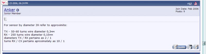

                  please help me for build coil for anker50??
                  l1-l2-l3????

                    Hi mesy64
                    What's Anker said , SS60 designed by Anker
                      Anker 50 and SS60 coils was similar .

                          Concentric coil included 3 coils, for more information, search US patents at geotech
                          Forum .
                          What's Anker said was complete, however,
                          RX/ CX= 10 /1 , CX= 25 turns
                            Forum .

                            I DROW A PLANE THAN COILS ANKER50.THIS PLANE IS CORRECT????
                            I SHUILD INSERT COILS SIMILAR PICTURE????????
                              In main page of Geotech you can learn how winding these coils. The opposite coil in winding (part of TX coil) is called bucking coil:
                              http://www.geotech1.com/cgi-bin/page...anar/index.dat
