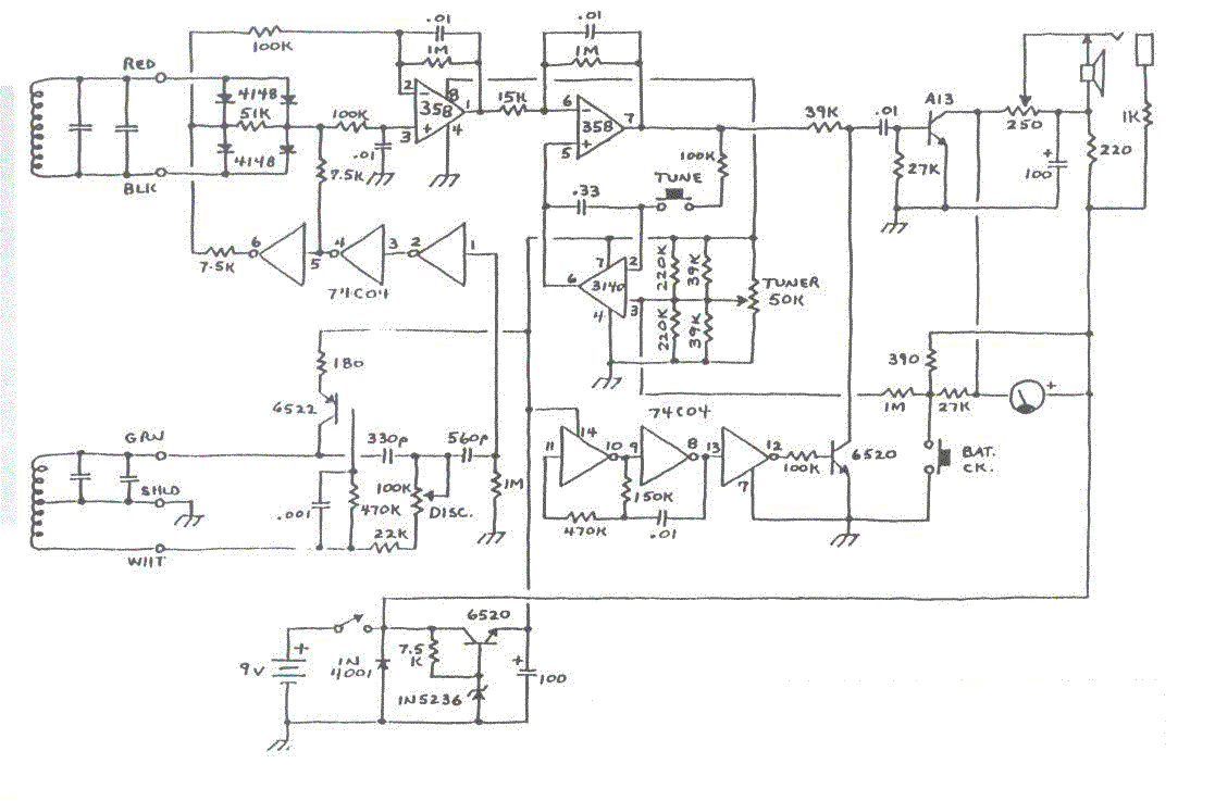

    Looks like a commercial detector (colors in the part of coil connection). What's the model?
    Re: md schema
    Hi
    It seem a White coinmaster
      realization circuitry
      HI
      cannot be start transmitting part nor her cannot on-simulate. isn't error in circuitry? any suggestion ?
      thanks
      LUBOS
      sorry my English

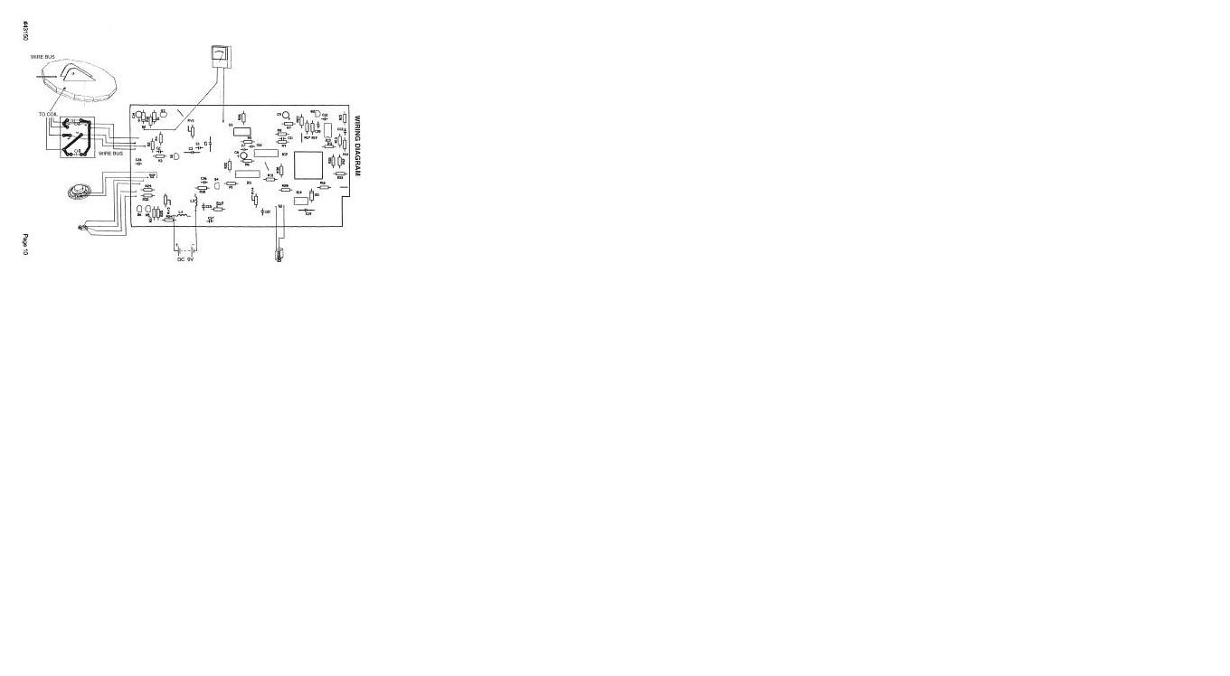

        md schema
        A friend buy a MD and I "sacrifice" and "dissect" it. The schematic like this kit type "MD toy". Sorry can't post all the manual (pdf 411 K), because the attachment of the forum is very limited in bytes.
        The coil of the kit is concentric (I thing the schematic posted too). The TX coil had 15 cm diameter + 48 / - 15 turns wire 0.15 mm with compensation short loop 5 cm long and the receiver 7 cm diameter 48 turns wire 0.15 mm.
