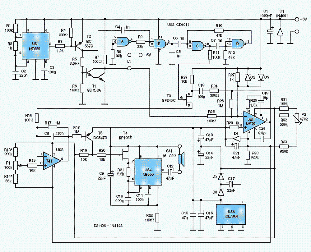

You have the PCB,?
    I have found PDF files. Inside a circuit board / But I want to copy it into the film.
    我发现PDF文件。内部电路板/但我想复制成片它。希望谁可以帮我[附上] 13324 [/重视]
    [附上] 13325 [/重视]

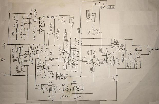

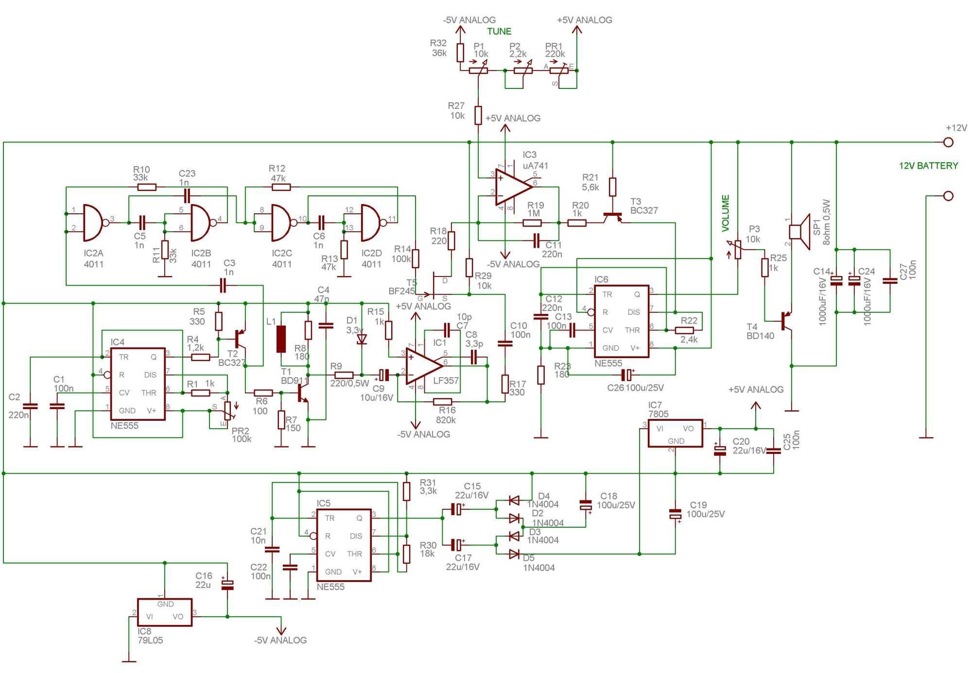

      good schematics for my archive... a content of it is 1.53 Gb now... by the way... THANKS. look also Surf PI schematic that is identical to this your Polish.
      look at this attached schematic too.
      good luck

        Need more information and LM709 4 feet .7 pin voltage
          Originally posted by yhl View Post
          Wykrywacz PI z Ep 8/2000

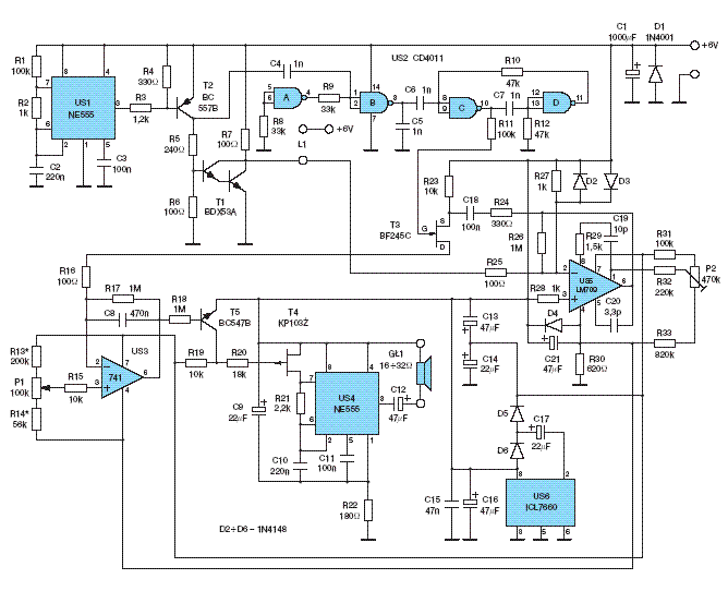

          Hi Yue Hailin.
          Here is your circuit digram drawn with larger dots to be visible where has connection.
          Pin 7 of US3 (LM741) and pin 7 of US5 (LM709) are connected to supply rail having increased (relative to battery) voltage. The increasing circuit is formed by US6 (ICL7660), D5, D6 and C17. The battery voltage 6V appears as intermediate supply voltage for US3 and US5.
          For filtering of negative supply voltage, pin 4 of US3 and pin 4 of US5 are connected not direct to zero rail. The filter is formed by R30 and C21.
