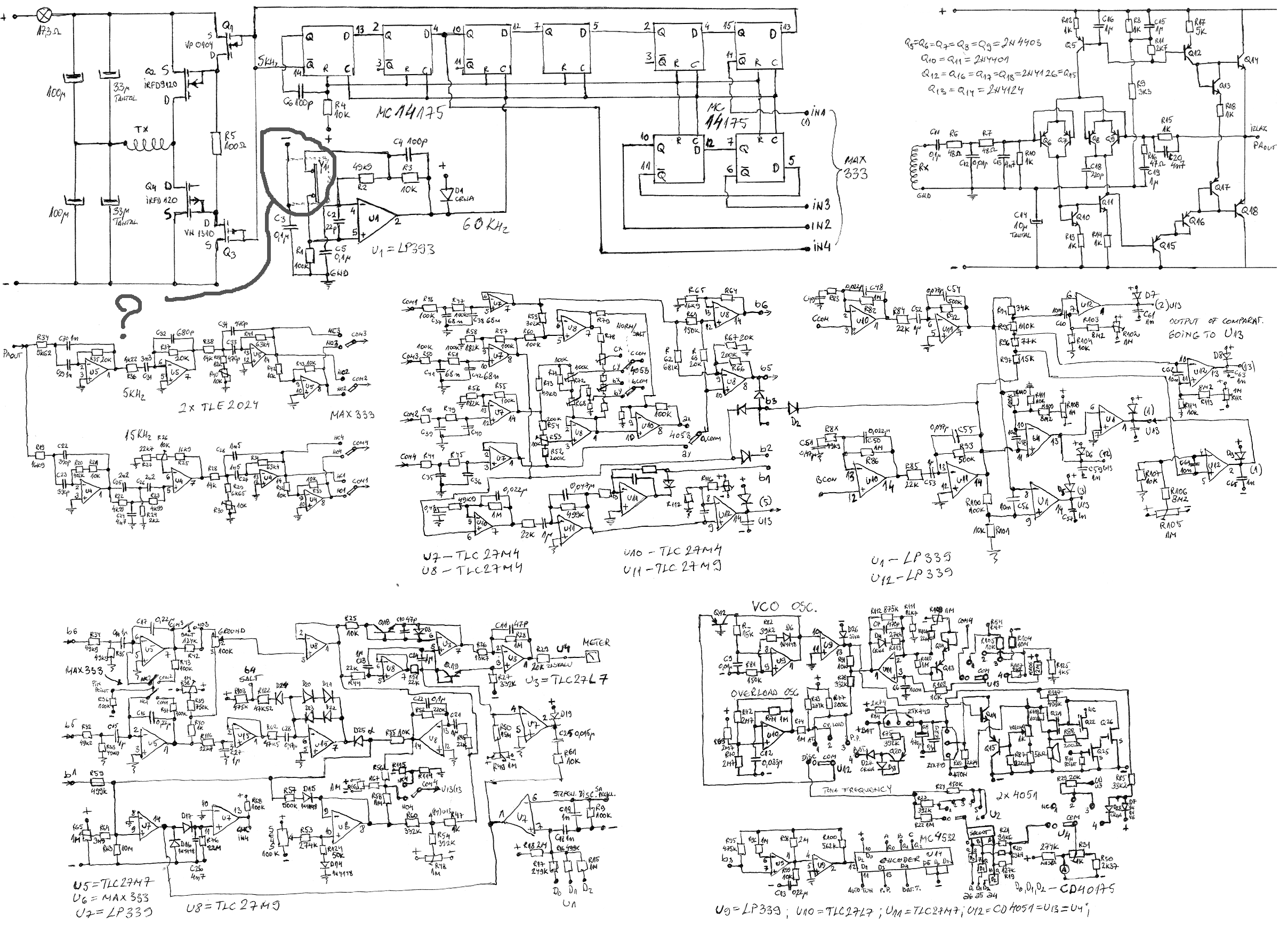

    hello
    which type of component is that one emphasized in the outline electrical ?
    quarz resonator
      cz5
      xtal 60Khz
        the schema is incorrec????
        mc14175 is a 4-stage divider, the output frequency is 5kHz to 80kHz input.
        The scheme shows a 3-stage divider with 60kHz input and output to 5 kHz, impossible, the output should be 7.5 kHz, with 3-stage divider
          cz 5
          If the crystal mesh and separation, I measured a two oscilloscope at the TX frequency - 5kHz and 15kHz

            I'm repairing a CZ5 a friend, tx 80kHz oscillator, mc14175 pin 14 and 10kHz,
            cd40175 to replace an mc14175?

              I thought I should ask for the value of the crystal. I have had CZ5D scheme and was ok. Values sat as I wrote.

                ok. well I checked the schema is correct,it is not a frequency divider (mc14175) but a shift register, and then on my CZ5 something else is wrong oscillator, oscillates at 10kHz

                  This Section establishes the need to replace the xtal.
                  I've sent the schema for address.

                    Tomorrow I try to connect the function generator, and check if it works with 60kHz signal
