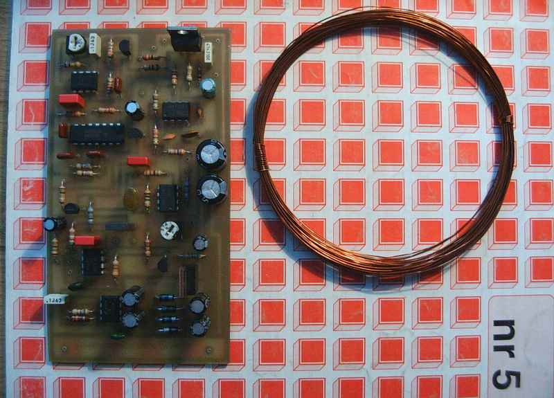

                      Hello,
                      Depends on the coil, 20 cm coil : 21 turns - 130 mA, 25 turns - 100 mA, 31 turns - 70 mA.
                      For wire I used 1000 Volts isolation wire (later more at Baracuda site..)
                      Al coils can detect a euro over 25 cm, the 21 turns coil can detect a euro / mans gold ring at some 30 cm !!
                      Best regards.
                      Ap

                          Hi ApBerg. What is the wire diameter? Please link to the site Baracuda.

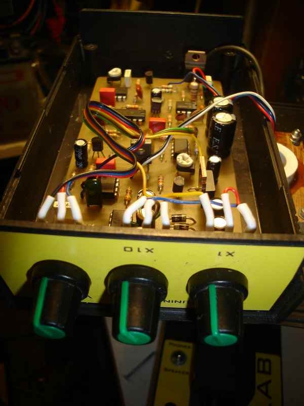

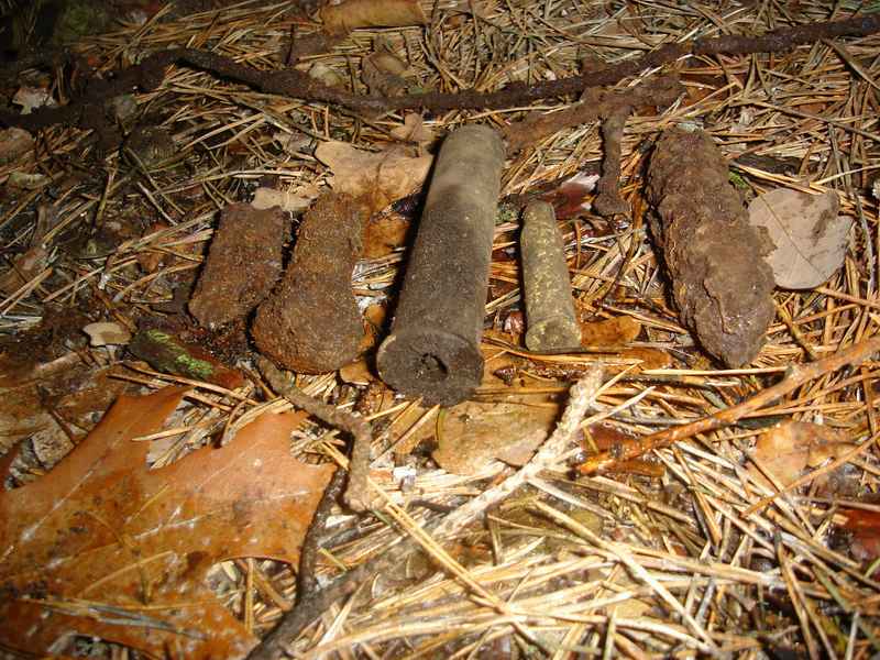

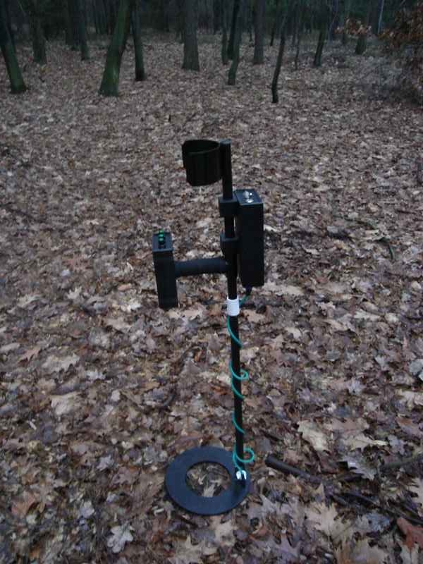

                              Hello Maikl,
                              Have made some photo's look at the bara site..
                              Best regards.
                              Ap
