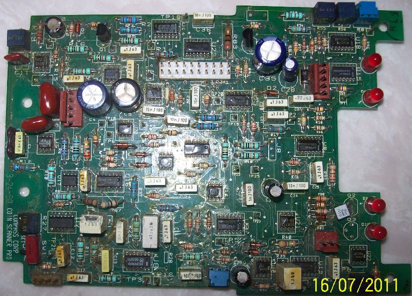

            Has anyone else noticed several discrepancies between the schematic and a CS Pro or Pro II actual circuit board? It appears the schematic was an early design even thou the schematic is dated 1-5-90 and the circuit board has a date of 3-24-90.
              There are always updates....
              From my knowledge of Compass, there are always updates and revisions, the original schematic was the original one. Then circuit problems and errors are found, thus one has to revise the schematic using the original schematic. That is why they put board dates on the boards.
              Melbeta
                I think that R7 should be connected to the other side of R6. I owned one of these detectors and it did not work well. A quarter would only air test at 6". I think there were a bunch sold that had problems and the BDS were probably wrong. The 1993 Bounty Hunter Select 220 that I own is a very similar variation of this design and it works great.

                  That was the point I was trying to make, changes, errors and the finished design is somewhat different than the original design and it appears the changes weren't made to the original schematic.
                  On the early Coin Scanners they would only get around 5 - 6" until Keith Wills started making a depth mod and then later the factory started making the depth mods themselves.

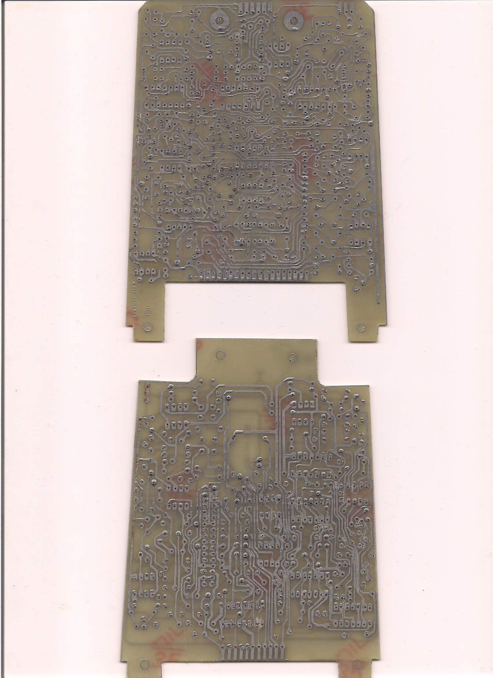

                  I have been trying to trace all connections, but some connections run under some of the components and it's hard to tell which way they run or what they connect to, plus the old coating has turned amber color and is hard to remove to check things. I'm trying to find a non working circuit board for the Coin Scanner Pro or the Pro II.
                    Hold it up to a lite, it helps. Also use an ohm meter to make sure they connect where you think. I know its not easy, I am about 90% complete on the select 220 schematic.
                      Interesting. I just sold a brand new Bounty Hunter Big Bud Pro 220 Select to one of my sons, as he liked that machine. Perhaps that modification is what Keith does to the detectors for more depth? The 220 Select was not as good as my Bounty Hunter Big Bud Pro SE that came from Tek Limited in Oregon, so I sold it brand new for $75.00 to my son. I had purchased it from a guy who only bought it to find his wife's lost diamond ring, once found, it went into storage, so only used one time and then sold to me for $75.00.
                      George Payne was involved with all but the 220 Select. The 220 Select used George Payne's patents technology though.
                      Merc posted some very good high resolution photos of the top and trace side of the Big Bud Pro SE unit in this forum in case you want to look at the top and trace side of it, to see what it does... I believe the 220 Select was a First Texas Mfg clone of the old Teknetics/BountyHunter Big Bud Pro SE unit.
