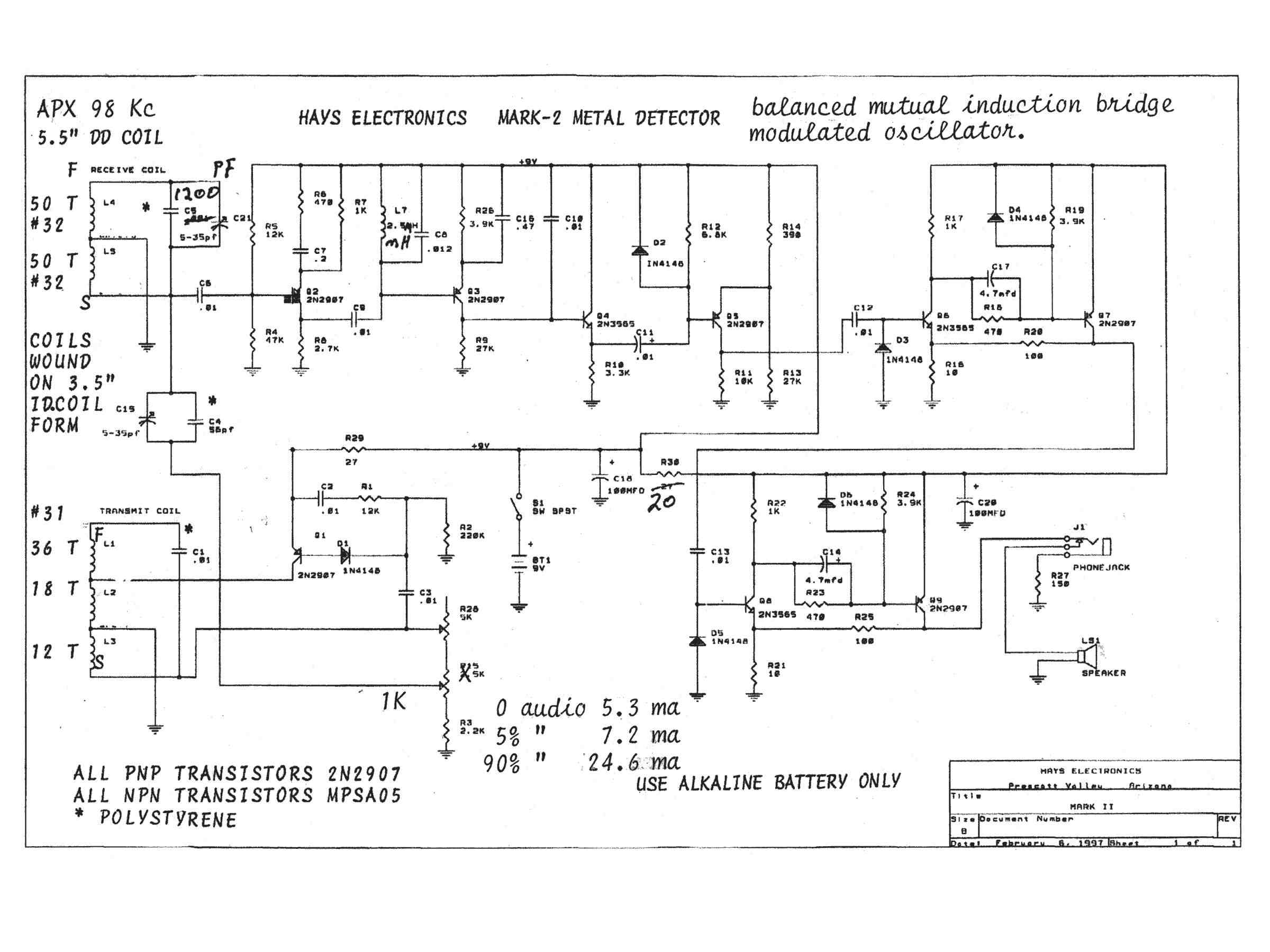

    I couldn't find the schematic for the Hays tr detectors so I thought I would post one for those interested to the Hays Mark 1 and Mark 2 metal detectors. As far as I know the only difference between the two is the coil size.

        Here is the info on the 8" coil used on the Hays units. The information was provided by Bill Hays on a different forum so I took the liberty to copy his information and post it here.
        Reg
        8" COIL WIDINGS, RECEIVER TOTAL TURNS 89 TAPED AT 45 TURNS, WOUND ON 5" I.D. COIL FORM,
        TX COIL FIRST TAP FROM STARTING WINDING IS 10. SECOND TAP IS 15 TURNS FINISH WINDING 30 TURNS ALSO WOUND ON A 5" I.D. COIL FORM
        BOTH WINDINGS ARE #31 WIRE.
          I talked to Bill Hays the other day and he informed me that this same detector was made under a different name early in its existence. Also, the schematic was different since it had fewer transistors.
          Now, here is the interesting part, the schematic posted can be used for the older versions but only part of it. The first part of the schematic up to 5 transistors was the schematic of the early model. Additional circuitry was added to increase sensitivity at a later date.
          So, the schematic still works even for the earlier models. You just use less of it.
