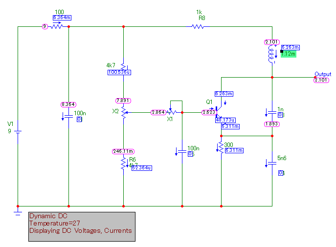

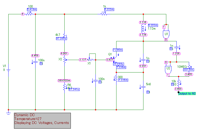

            I made circuit below. Orginal circuit is from Eti561 coil part. This produces about 100-300kHZ signal I guess with amplitude of 2v and 4Vpp. Best part is that it looks driving 6mA thrue search coil and would make quite nice magnetic field. One note is that 3904 is in saturating contition. How will this affect? I made it Linear also but then amplitude is 5v wich is bad for nand gates. If the saturation affects circuit, how could I improve the circuit to be able to obtain Linear mode and 1-2v amplitude. Does the 4110 accept 4vpp to the inputs?
            Also asking if it is better to have 9v amplitude to obtain best magnetic field, then reduce the amplitude for nand gates?
            Anymore to do is to study how this circuit would connect to nand gates of simple BFO detector circuit? How would I connect the N3 and N4 gates and drive result to N2 input?
            I made same values as orginal script in second photo inculded. Is this right way to do it?
              Have to add that in the second photo it seems that transistor is in linear contition and I am guessing that it would be good and the circuitry would work like charm?
                Great news! I made Eti561 schematic. Unfortunately I dont have time to test if it works, but the nand gates accept 10v as input so I can have coil with 9volts adjusting resitors. Also I did in 2 days trying to change the coil freguency as my coil ran with normal combonents as 158khz with lowest pot settings. So I finally today changed the 1n to 2n and did put 33n to ground on coil transistor. Now it reduced it to 106khz in loews pot setting wich is marvelous as I can now adjust the freguensy about 20kilos to up and nearly 5kilos to down from 111khz wihc is recommended in the eti561 pdf.

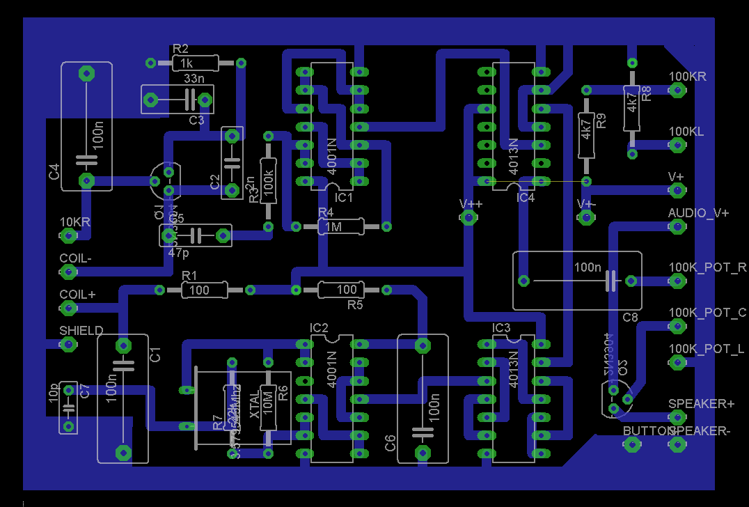

                  I did a layout for eti651 with my cap values for 25cm outer dia of 30 runs and inner dia 12,5 against 55 runs coil. 33n and 2n in the circuit to make 106khz and can make more higher with course pot. Image, pdf for printing and circuit zip if one wants to edit circuitry attached.

                        The layout image has a bug. The software had an bug that it did notice that the output pin of first nand gate must be connected to 10MEG leg. I suddenly noticed why it's leg is not connected to anywhere. I the removed wiring on schema and put wirings again and then program did see that there is missing connection. So admin, give me right to edit the photo.

                            Hello, I need some advise. I get good signals from both oscilators on eti561 mobo. How ever the final chip the fliplop outputs only some millivolts and then cannot open the transistor which I have 2n3904.
                            I have coil kiloherts arround 111khz to 125khz and the output should have good feedback if coil is adjusted more than 111khz. How ever I get no sound from output. The transistor base dont get more than millivolts and thus don't amplify sound at all. How ever I get few khz signal from output, but some microamps output.
                            How come the final stage flipflop dont output more ac amplitude to get the transitor working?
                            My headphones is potted one and can be adjusted from 4ohms to 800 ohms and if you put both speakers to mono you will get up to 400ohm resistans. So resitans should not be issue here.
                            How ever, I had a bit weak batteries so tomorrow will test new ones. I can hear sound if I touch voltmeter on headphones trace kind of low herz breaking signal similar when speakers are connected to live receiver.
                            I found two mistakes on the mobo, one was small trace on nand gates that I did cut, then I found audio voltage and main voltage connected because autorouter and cut that one also. The first fix gave my ntsc oscillator to work and second one did not affect about nothing to sound output stage.
                            The main issue is because final flipflop dont give enough voltage out, the transitor does not work, and speakers are dead.
                            I can see trough oscillator that output varies about 3khz depending if I touch metal or free air meaning that the flipflop at least does output audible khz signal but it's not amplified at all.
                            So take a look about the circuit. My mobo gives that 890khz to flipflop. Also my coil provides 111-126khz. The reason is low voltage ouputs.
                            Chips are:
                            4013BN
                            4001B dont remember maybe this one right.
                            Both transitors are 2n3904's.
                            If somebody have ideas why I lack proper ouput from flipflop to audio stage, please point me about it.

                              I don't know it this has anything to do with your problem but any unused inputs on your CD4xxx chips should go somewhere.
                              IC4B has a few pins to take care of. I'm talking about SET, RST, D, and CK. Either tie them to ground or take them high, but do not leave them floating.
                              • #45
                                Orginal circuit left them floating also. I think my 4013 in the output stage is blown. It just wont output any 101010. Only trash looking 4meghz signal output.
