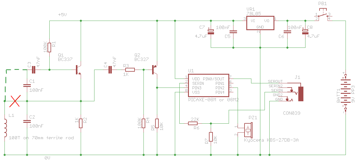

              @igull :
              I think there is a mistake in your schematic.
              One side of the coil is connected to the ground and the other side must be connected between C1 & C3.
              Am I wrong ?
              Another thing ; What is the inductance of the coil ? The diameter of the ferrite rod (7-8mm) ? What is the expected frequency at the input of the Picaxe ?
              Hugo

                Hi Hugo
                You win the 1 euro prize - you are the only one that spotted my deliberate error
                Yes, of course you are correct, it's a colpitts oscillator - my schematic is wrong, sorry - I should just have scanned my notepad version rather than converting it to eagle. My veroboard layout is correctly wired however (I checked just in case!).
                I have no idea what the inductace of the coil is - there are probably online charts that can quickly give you an idea - it was a case of pulling turns until it was close to 40KHz which is the frequency - 25uS.
                Ferrite rod diameter is 9.525x70mm - actually an imperial measurement of 3/8" - from a 100 year old transistor radio
                I've attached an updated schematic.

                  @igull :
                  Only 1 Euro ! Too bad, I wish I had won more !
                  The oscillator frequency is enough for me.
                  I'll calculate the coil.
                  Thank you,
                  Hugo
                    Hi everybody,
                    I've made this pinpointer with success.
                    But my first tests were quite poor.
                    The detecting range was less than 1 cm for a 1 euro coin.
                    Several tests later, I can reach 2 cm !
                    My mods :
                    Same coil but C2 increased up to 570nF. This decreases the osc. frequency down to about 23Khz.
                    I re-wrote the basic code too :
