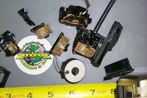

    Re: Transducer check and a fishfinder pic
    [img]../images/fishfinder.jpg[/img]

    And here is a pic of the transducer I dismantaled.
      Tod,
      I assume the round object is the transducer. It looks like the whole transducer was encapsulated in a cork-epoxy material.
      What kind (manufacturer) of transducer was it?
      How heavy was the bowling ball that was used to open it up?
      Patrick
        I don't know manufacturer, but it dim's are 1.1 D x .41 thick and operated at 200KHz.
