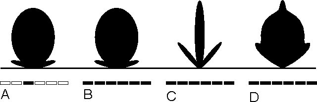

                        Yes, that's right, if the transducers are not in phase or have different modes of oscillation the pattern may look very much different. For that reason I simulated the transducers only with a dynamic of 25dB, not with 50 dB, as many diagrams are shown (an exception is the section "can we trust the results"). What lies below -25dB is dominated by such side effects. Luckily "in phase" in this case means that the perhaps10 to 50 oscillations within a single pulse are in phase, so that differences in the resonance frequency should be lower than about 3 percent estimated.
                        I have tried to make a sketch what happens if the transducers are only partially in phase, its simply a drawing, not a simulation.
                        A is the pattern of a single transducer of the row. B would be the pattern of this row, if all transducers are firing, but are completely incoherent (not in phase, they all have different frequencies). The pattern is the same as for the single transducer (when viewed from far away from the transducer), with the only difference that you can pass more energy through it. C is the pattern for all crystals in phase, as desired for a real system, and as assumed by all of my simulations. D is for a transducer when the elements are only partially in phase, it is an intermediate state of the coherent case C and the completely incoherent case B. This transducer would have a very bad signal-to-noise ratio, because the broad lobe would introduce a high diffuse background. But real sonar systems are rather case C than D, as can be seen in measured beampattern.
