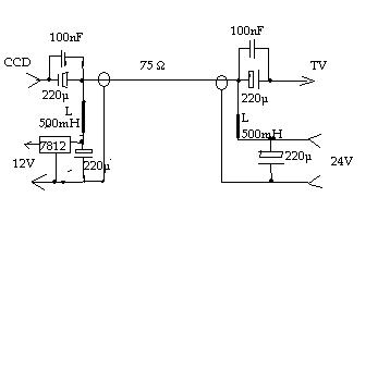

                If you mast use only coax-cable, there no problem to send TV and DC in one cable.
                You can separate signal and supply with simple schematic.This I check on 100m RG-59(75 Om)

                    the schematic from http://www.qsl.net/sm7ovk/schema_biastee.jpg isn't good for TV band.It is good for RF.
                    In my schematic ,I use big inductance(500mH) to stop all AC component and schematic give good results.
                    Of course , there is better schematic with RF and DC-DC module for lines to 300-500m, but they are more complicated. If you need I will send you schematic.

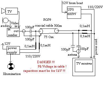

                        this schematic is commercial development, I can't give it all. But I will mention how to do easy version. You need common TVsender at 1-4 TVchannel, UPS 110/220V 600VA with 12V accumulator, pulse power supply for 110/220V for 12V/ 2A or more, TV receiver 14"(with pulse power supply) and some electronics parts.
                        For CCIRT standart:
                        First mast to stabilize the frequency of sender by input quartz at 49,75 ; 59,25 or 77,25 MHz and increase output power on 20dB by 1 transistor.This sender will send full colour TV spectrum.
                        Look at the picture.If you have any questions, I am here.
