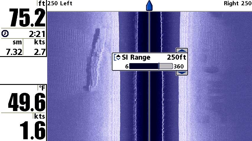

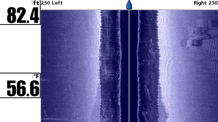

    The 'Before' and the 'After'.......
    Some results from this afternoon on the wreck of the Elk, which I believe was a converted trawler, lost to enemy action during the last major shindig.
    The first image (if I manage to get them in the correct order) shows last years effort and the subsequent one, this afternoons. The difference isn't the weather, because if anything, it was worse today....the changes that have been made were those discussed above. If anybody can explain all the mid-water detail on the early shot, then please have a go!
