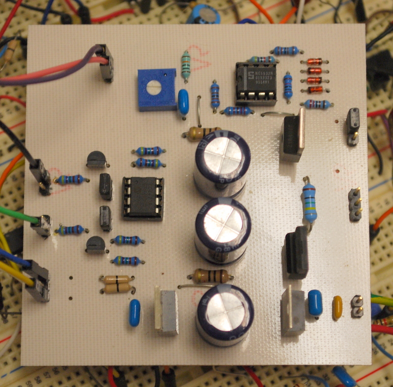

                  Hi Mick,
                  Here's a picture of what I did to avoid bread board problems. Its almost the same as the schematic I posted under the original bipolar pulsing thread. I added the dual fet driver TC4427A, with 2 pnp level shifters and jumpers so it can be switched highside or low side. The preamp is from the GS5 with a gain about 500. I found after experimenting with virtual ground circuits, it worked just as well without a supply splitter and just the two electrolytic caps. As long as you keep the n and p switching times symetrical the caps seem to maintain a good virtual ground. This is all on the pcb. Almost the same timmings as you 120uS pulse at about 3.1khz. The supply is 14 volts regulated to 10v, with the virtual ground it gives you a +/-5volts for your analog without additional regulators
                  I bread boarded the demodulator from the GS5 schematic and added a vco and some other things missing from the schematic. It was sensistive and could ground balance. Never had any problems with detecting the hand.
                    Hi Altra, I'm impressed, thanks for posting the picture. I'll post up some pictures of my "Manhattan Style" board later.
                    I actually noticed whilst I was trying to solve the Virtual Ground problem that it would run with only the caps connected, I also noticed less whistling coming from the coil and lower current draw, also slightly less depth.

                      Hey Mick,
                      The minelab coil (11inDD) caused my circuit to be unstable. Need to limit the current.
                      I am using a 3 ohm coil vs minelab 1/2 ohm. "Manhattan Style" thats funny we used to call it "Dead Bug"
