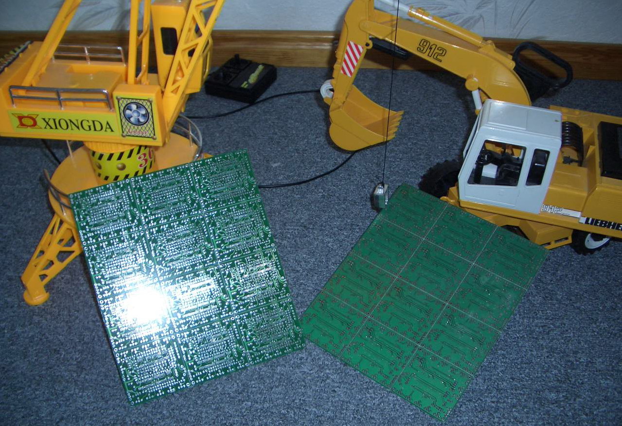

            The IGSL and the TGSL are different.
            IGSL has 2 Disc channels
            TGSL has 1
            So TGSL is easier to make and ALIGN and USE in the field.
            The IGSL has a tone for Fe and one for non Fe
            The TGSL has only one tone
            I would start this if you have acces to a scope.
            No Scope - I would take my chances with the mines and a Surf Pi.
            As for the postage its about 2000 Euros
            S
            King Cobra is more advanced schematic. it has very effective NOTCH FILTER, TWO tone sound in DISC mode, very simple realization, done on non-expensive components. King Cobra is same cumulative and some kinda compilation like HAMMERHEAD is the compilation of all PI schematics (great job of Carl Moreland carried out). with Surf PI you will dig all nail trash whiile King Cobra has the discrimination FERROUS-NONFERROUS and NOTCH FILTER. if you will wish to add VDI maybe in future I made special points for connecting of VDI board.
            good luck
              Postage for 1 kit within EU will be less than 5 euro (airmail)

              What kit should i get for a TGSL?
              This?
              http://www.silverdog.co.uk/shop/inde...&product_id=99
              Or this?
              http://www.silverdog.co.uk/shop/inde...product_id=111
              Also, does someone know what the shipping costs are inside E.U?

                          1) What coil type would be the best for soil with lots of trash? VLF?
                          2) Can IGSL be used with this type coil?
                          3) How King Cobra compares with IGSL, and how these two compare with detectors from the market?
                          4) Does the King Cobra PCB comes with components?
                          5) Any suggestions about Sound Cards are welcome.

                                who buy from me King Cobra PCB FIRST will get a board on Hammerhead FOR FREE, like the BONUS. I strictly hope silverdog will do the bonus too and put FREE Surf PI board for you!
