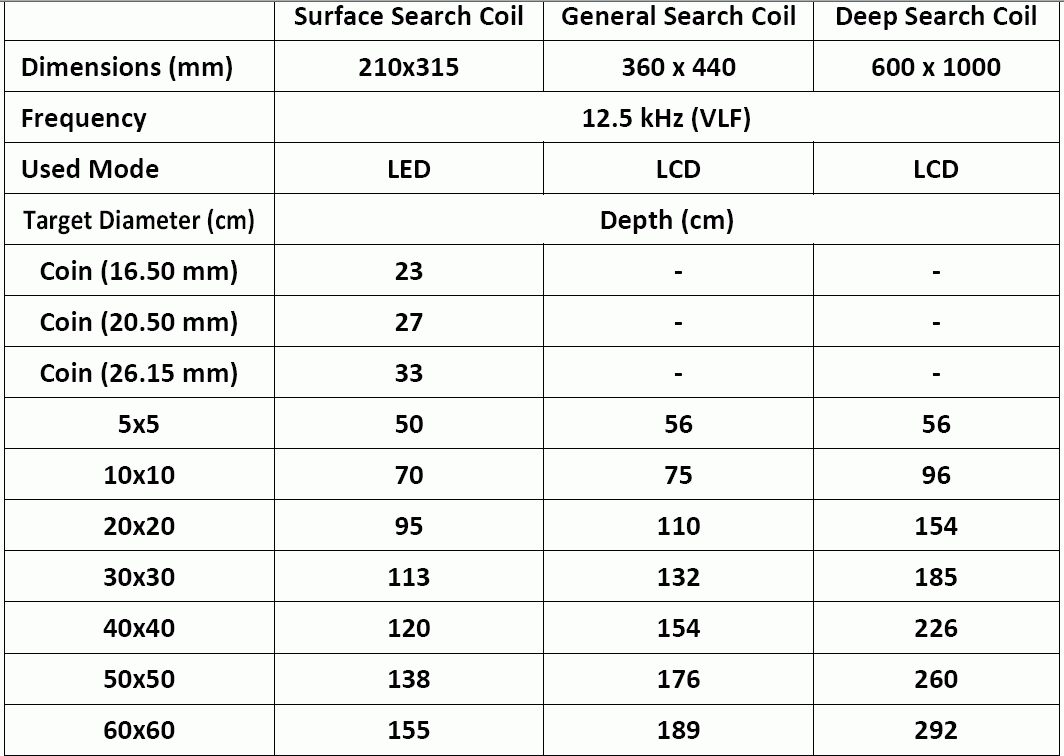

    • #77
      I mean: if i buy a detector with a 10 inch coil, and i replace the 10 inch coil with a 3 ft coil, will the detector be able to work and detect in the depth a 3 ft coil would normally detect?
      Or would i need a detector made for 3 ft coils?
      • #78
        Originally posted by RelicHunter88 View Post
        One more question.
        If a detector comes from the factory with a coil of certain diameter, let us say 10 inches, does this mea that the detector works better with coils of this diameter?
        If we put a larger coil to a detector, will this make a detector work worse?
        Of course a larger coil will be less sensitive, but can the detector work well with a larger coil?
        For example, with a coil of 3 ft, a detector made for 10 inch coils, will detect targets at 18 - 15 ft depth, or worse?
        where the coil of 3 ft?

          as long as your Tx and Rx inductivities and resistances are within the tolerances for the concept you are building - it will be the same.
          Some people do build large frames to house even larger coils, so why not.
          Counter-question: are you sure you will dig when you detect something that deep?

            relichunter,
            if the used transmission power ist too weak and if the
            detection circuit has no good signal range scale you
            will find nothing with a large coil!
            Connecting a cheap ferritecoil pinpointer to a 50cm coil
            will not give you 1meter of depth detection, even if you
            are using 500 windings.
            Gaining depth also has to do with the distance of the coils.
            The Garrett GTI 2500 works with a small but also with the
            special "2 box" deep coil. The Nexus uses large oo coils
            that have more distance for better depth.

              I prefer to use a little bit "extreme" examples, in that case a coil 3 ft in diameter, because if i learn that a detector will work with one of those, then other smaller coils, will be covered in one answer. That way i do not ask now about a coil 1 ft in diameter, later about a coil 2 ft in diameter and later about a coil 3 ft in diameter. If a coil that large does not work, an answer with some detail about "why" and "how", will be sufficient.
              I just want to know more about coils.
              Also i need these info to design a coil for the detector i will build.
              King Cobra came from the factory with a 8 inch coil. If it cannot support larger coils, then we have a little problem. I do not speak about 3 ft coils (for now ) but a coil about 1 ft.
              So, the way i understand it, most detectors will work with larger or smaller coils, but if i need to use a relatively large coil, let us say, 3 ft, i will probably need another detector. But if i want use a coil 1 ft in diameter, it will most probably work.

                The standard coil supplied by the factory is chosen as a general purpose size for that detector. You can fit a larger coil (say, 12" diameter) in order to find deeper targets, although the extra depth will not be dramatic. It will be less sensitive to small targets, and less able to separate out individual targets. For trashy areas, use a smaller coil. Large 3' diameter coils can only really be used with a non-motion detector, and most commonly with pulse-induction.

                    The 8'' (20cm) Cobra coil is too small for your purposes.
                    Yesterday I was hunting with the Blisstool with 28cm coil
                    and even that one is too small for larger areas.
                    You should built a coil of 35-40cm for relics minimum!
                    Concerning the coil size depth relation below you can see the
                    approximate depth tests with new objects of the Jeohunter.
                    There is no coin distance for standard and large coil but I have
                    both of them and a canadian silver dollar is detectable at ca.
                    30-40cm with both of them!
                    I also found an 1cm button and 1.5cm coins with the standard
                    coil - at 5-10cm depth. And a 45x35cm Alu-case was detectable
                    in air from 2m @ 100% sensitivity but buried it will be ca. 1,3 m
                    @ 80% sensitivity.
                    Below you can see that the real depth advantage for the 1m coil
                    starts for objects of ca. 20x20 to 30x30cm.
                    But for investigating a huge area in a short time
                    the 1m coil is very useful for 5cm finds and larger.
                    War-sites usually also are very extensive and the relics are mostly
                    larger than 3cm so the best coil size would be from 35 to 60cm.
                    The doubled amount of coil-area (200%) gives ca. 50% more
                    depth than before if the target is large enough.
                    Plus you only need the half amount of time and sweep work.
