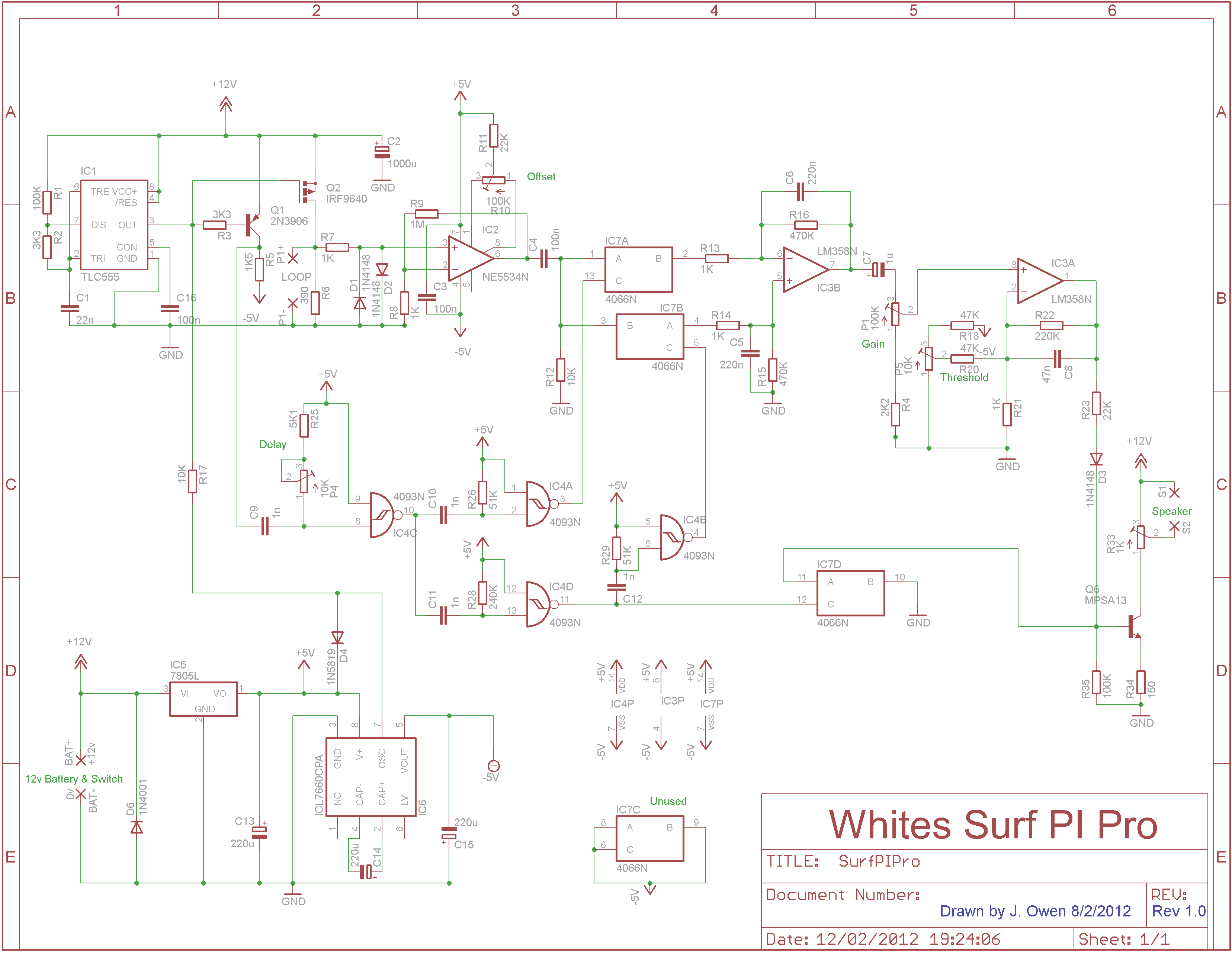

                      Hi Mschmahl,
                      I work also with DIY SM. I wonder what kind of coil is being used in the clip. I tried to register to that site but I haven't 'u' with points above. So you have an access to the pictures. Can you post the scheme with all changes in it? Would be appreciated!
                      Regards.

                        Hi xycy,
                        i don´t have a scheme with all the changes. But i will try to post all changes.Click image for larger version
                        This is the original scheme that i use.
                        I use the delaypot 20k not 10k.
                        C2 is 3300 uF not 1000uF.
                        Than i made the Delaymod from ossamaussama http://www.geotech1.com/forums/showt...587#post158587, so that my delaypot worked.
ID:	333772Click image for larger version
ID:	333773Click image for larger version
                        The next is the Damping Resister. I have changed it to 270 Ohm
Name:	Damping 270r pin6 0v.jpg
                        The next change is the op-amp NE5534 to LT1115 and playing a little bit with offset for max depth.
                        Now the signal is smoother.
                        Now changing Timing similar to what has described tepco.
                        For first sample from 33us to 22us change R26 to 33k. The same for second sample change R29 to 33k. Changing the intersample from 142us to 22us through R28 to 33k.
                        Change frequency from 596 Hz to 5,02kHz through R1 to 10k. Change pulse-on time from 46us to 20us through R2 to 1,2k.
                        Now the Pulse is changed from 1,6ms to 180us.
                        That´s all.
                        The coil is wound in a water pipe 27cm x 23 cm. It has 199 uH and 2,0 Ohm.
                          Hi Mschmahl,
                          Thank you for the answer. Is it better with 1uf fot C7?
                          Is LT1115 better then NE5534?
                          Have you more PCBs? I have difficulties making such. May I purchase one?
                          Also Im using batteries for -5V. I tried to make -5V without synchronizing it with 555 and had much interference. If you get ~30cm depth then using 7660 is OK, right?
                          Regards.
                            LT1115 is surely better than NE5534, but also 6 times more expensive. MAX410 is right in a middle in quality, price and availability between these two, and better suited for the 1kohm source resistance of a surf PI.

                              Hi xycy.
                              With C7 0,5 uF you have to swing faster than with 1uF. I like swinging slow, so i use 1 uF. I don´t have PCB´s.
                              Using 7660 is ok. I use TC7660CPA and TC7660S. ​Both are OK.
                              For LT1115 read Davor´s post.
