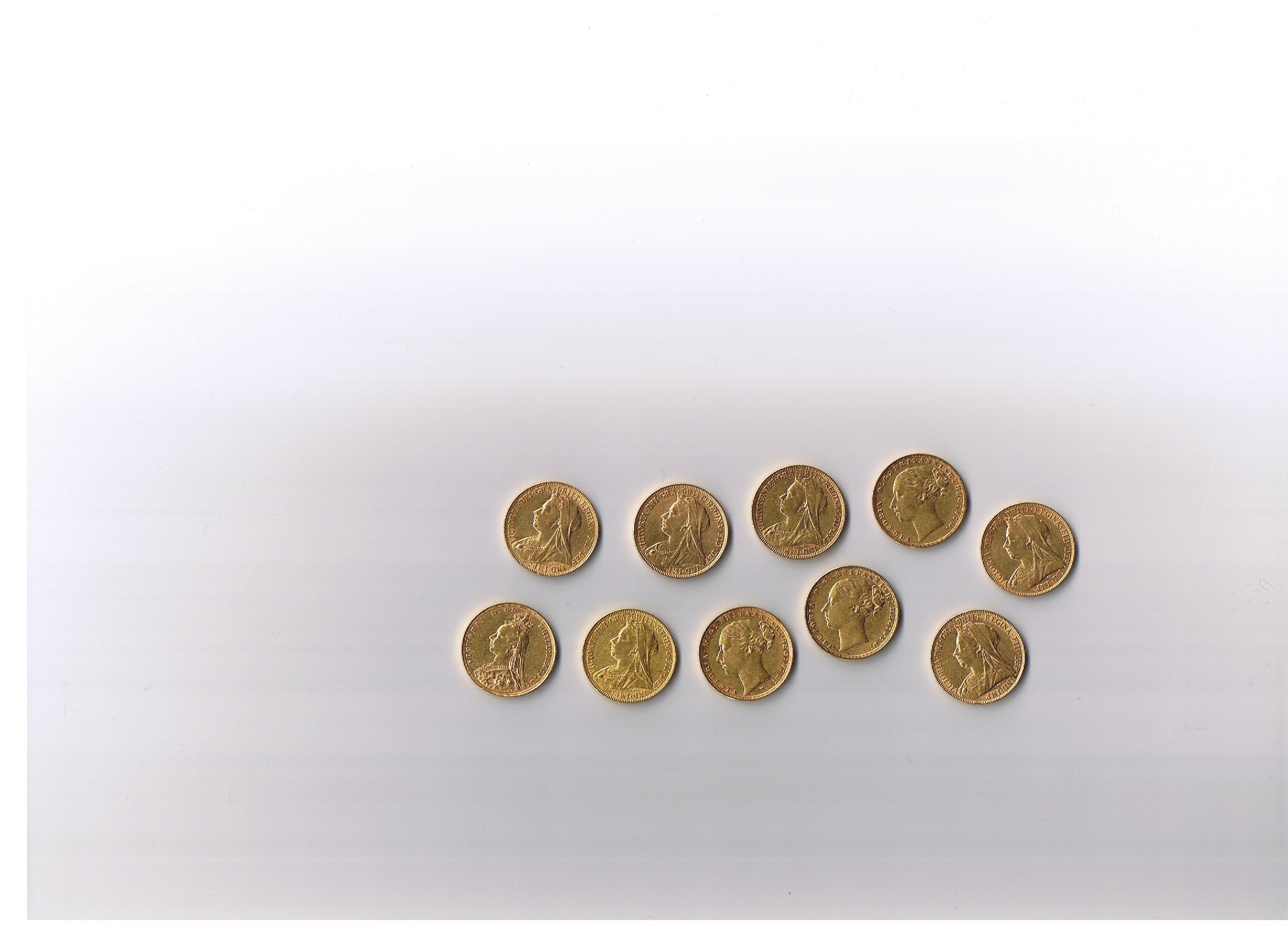

                            Hi Jim.
                            I am not sure if i said wrong name about the coins.
                            I attach a photo with same coins. They have 22mm diameter and 8gr weight each
                              If it's any help, British gold full sovereigns (8 grams) are 22 carat (0.917 fine) gold. Their 'natural frequency' is about 7.4KHz based on (90+45)=135 degrees phase lag.
