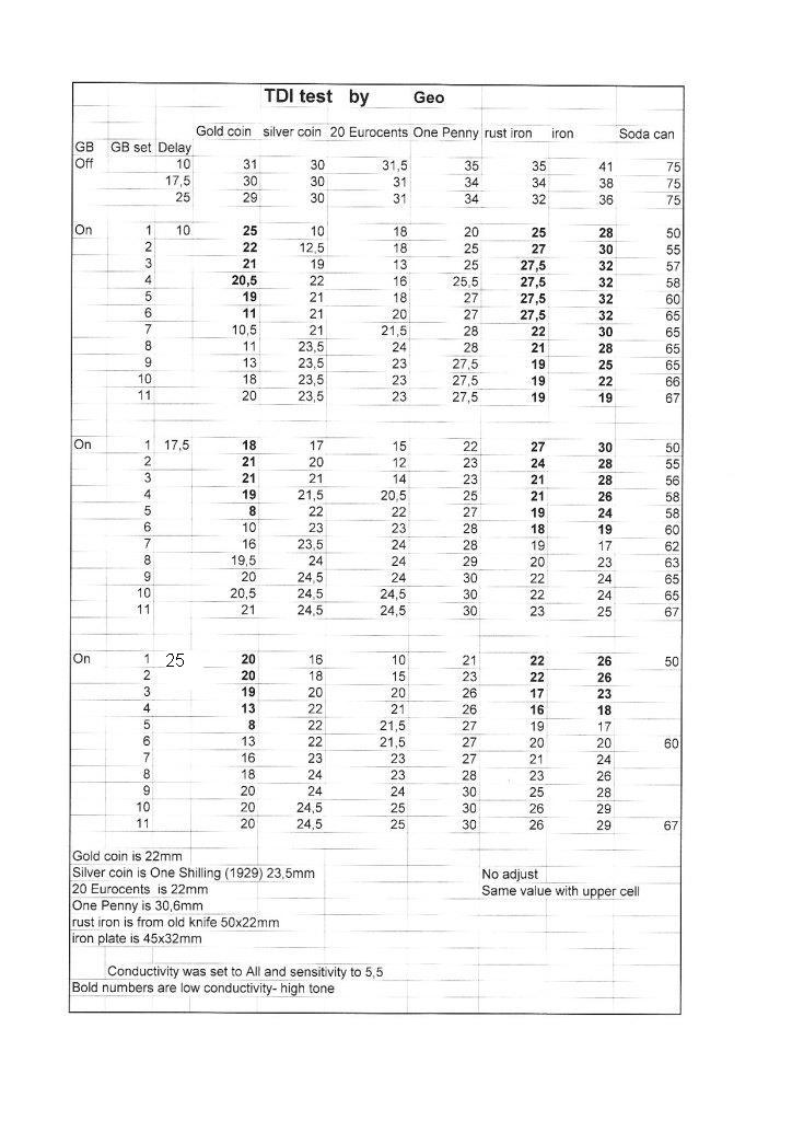

    Some years ago i posted the below table.
    As i see now, TDI detected one gold coin as high conductivity with delay=10 and GB between 7 and 11. But for 45 coins it reversed the conductivity!!!!!.
    For delay=10 and GB= 7...9 TDI has the lower depth for gold. So I must make again the test with the 45 coins and i think that it is time to change the adjusting of the TDI and the way that i use it. Maybe it is time to keep low or high GB and the coil far from the ground ......

      The conductivity of the coins shouldn't have changed and still should be a high conductor at a delay of 10 usec and a GB at 9 to max. So, something else is wrong.
      If you are looking for maximum depth of detection on those gold coins, then it appears you can gain depth by increasing the delay to maximum delay which should minimize or at least reduce the ground signal and then turn the GB off. You will have no form of discrimination this way, but will maximize depth.
      With the GB off you should be able to turn the sensitivity to maximum which should help gain more depth also.
      Then you can try a larger coil and gain a few more inches in depth.

              Hi Reg.
              I am interesting for max depth but with a kind of discrimination. If the GB is off then i must keep the disk at least 15 cm over the ground, and so i lose again the depth. From my experiences i saw that i had the best results when GB was on and the disk was closed to ground. I have the 12" dual field coil, also i have a homemade 60cm coil and another 105cm coil. The 60cm work very good after the 15us and the 105 cm after the 17us. When i tried the TDI with the gold coins i had the 12" coil. I have a friend with Minelab GPX so i will try the DD coils of it.
