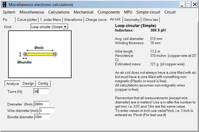

    So using this calculator, what are the parameters you inputting and what type of coil are you using if you say intend to make an 8" mono.
    It was choking on my inputs. Also it keeps saying the program is too old and to contact the author for a new version.
    The program ask from time to time for an update. (free)

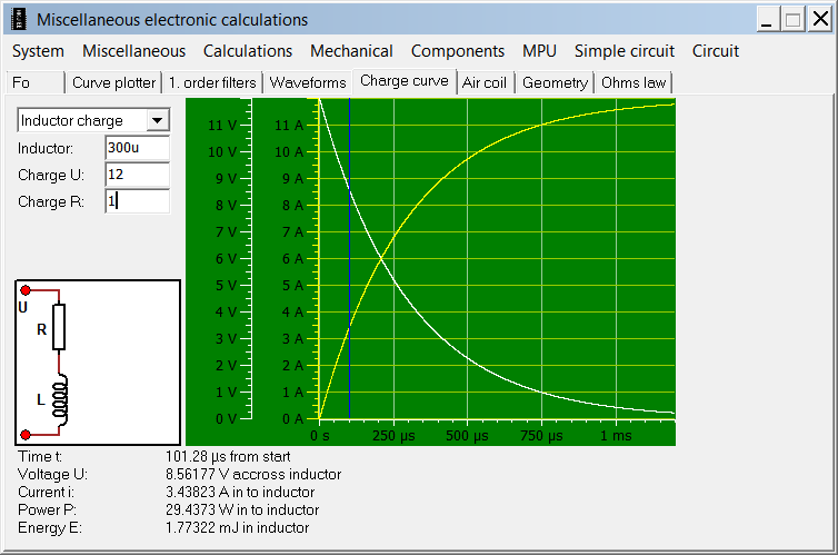

    Below is the screen for an 8" coil, 300uH
    The second picture is of the coil current at 101us TX
      How do you enter a wire diameter less than 1mm? That's what was stopping me. It wouldn't take ".511" for 24AWG for example.
      Also I note that it says the coil resistance is 370 mohms and in the upper section you used 1 ohm. Will it take less than 1 ohm?

        .511 is just over 1/2 inch,maybe you want .051
          The default measurement is in mm. - but looks like 1mm is smallest you can enter(?)
            Try 0.511 for the wire thickness/
            The resistance shown is 370mili Ohm. for 0,511mm wire the resistance will be 1.4 Ohm.
            For the coil current I used 1 Ohm total resistance, like Mosfet 450mOhm, wire 370mOhm, cable etc. 180mOhm= 1 Ohm total resistance.
            When you use plastic insulated wire, rated 600 V the bundle thickness will increase. Note that the inductance decreases as the bundle diameter increases with the same wire.
            When you wind a bundle coil, the inductance changes also depending how tight you tie the bundle.
