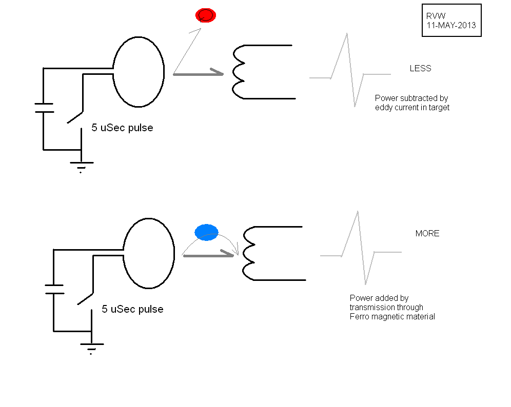

    I find this works (attached), for anyone who is interested.
    And it works like this:
    Iron encourages the magnetic field, and allows better transfer of energy to the secondary coil.
    Conductive targets steal energy with their eddy currents.
    Experiment:
    Rotate a bottle cap above;at some orientations, the Fe effect will dominate and increase power transfer, at other times the eddy current will dominate and decrease power transfer.

    I have been hunting relics for many years and have not observed this phenomena in the field. To the contrary, of iron "encouraging" the signal, iron gives an abrupt signal with a sharp cut off. It is often broken and usually won't center with the coil. The received signal seems to be distorted or interfered with in some way. Non-ferrous gives a smooth "sweet" sound that centers and what us oldtimers (that still sometimes hunt all metal by ear) like to hear. I will agree that this is related to magnetization of the target, and something that has not been quantified electronically. Maybe a new coil design would accentuate this difference. I remember that the old Garrett co-axial coil was especially good for this kind of hunting.

      You're right,
      I am familiar with the broken sound of iron, and the double sound of a nail..
      My explanation for this is that because iron has both an eddy current and a field effect, and the center of these is in different positions on the target.
      And the effects are opposite.
      So, sweep across the side-ways nail (as you know) you get: Mag field on the tip (no signal, because the detector is trying to detect eddy currents), then Eddy current normal signal in the middle, then abrupt no signal as the mag field at the end of the nail is more dominant.
      A piece of wire is even more chaotic as different positions and orientations it is either an eddy current more, or a mag field more.
      Something like that.
      i.e if you have a perfectly vertical nail or tent peg, as you know, it sounds quite 'sweet', like a coin. because all the effects are lined up and there is no jagged fluctuations as you pass over it..
      I am only familiar with using a PI detector..
      The iron does encourage the field, but doesn't encourage the audio signal on the PI because it is setup to detect eddy currents.. the mag field works opposite and 'blanks the signal...
      (The above is all conjecture, but I think it makes sense)

        Hi Tec,
        Good observation. You mention being familiar with PI detectors. I have a White's VLF detector, and it behaves exactly the same way. Apparently, the shape of the coil excitation current is immaterial.
        All the best,
        Allan
