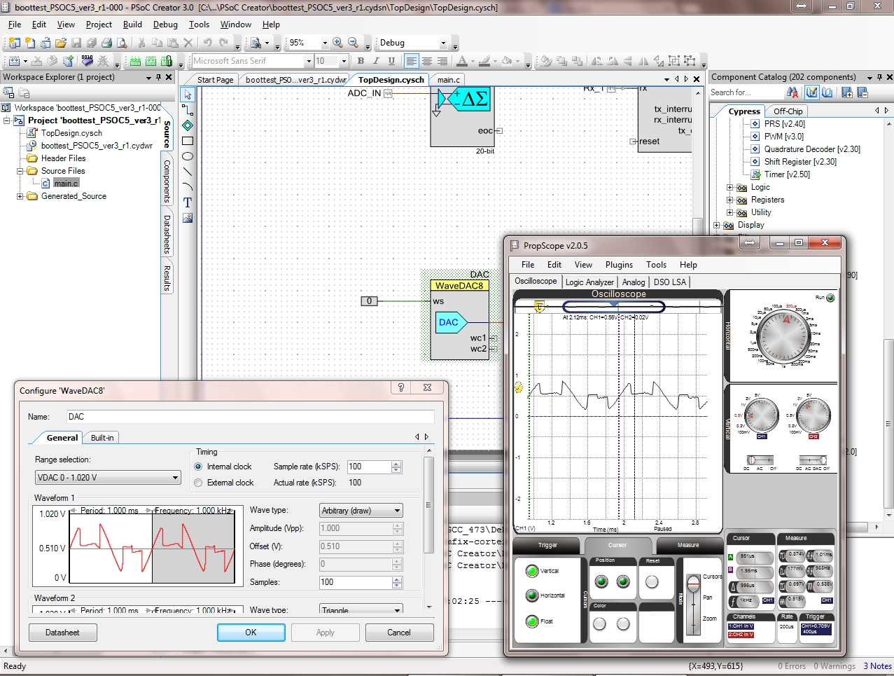

      Tried out the PSOC 5's waveform DAC in Creator 3 today. I utilized the arbitrary waveform capability to "draw" the waveform in the configuration window, and then built amd ran the project hooked up to the scope. Really cool stuff.

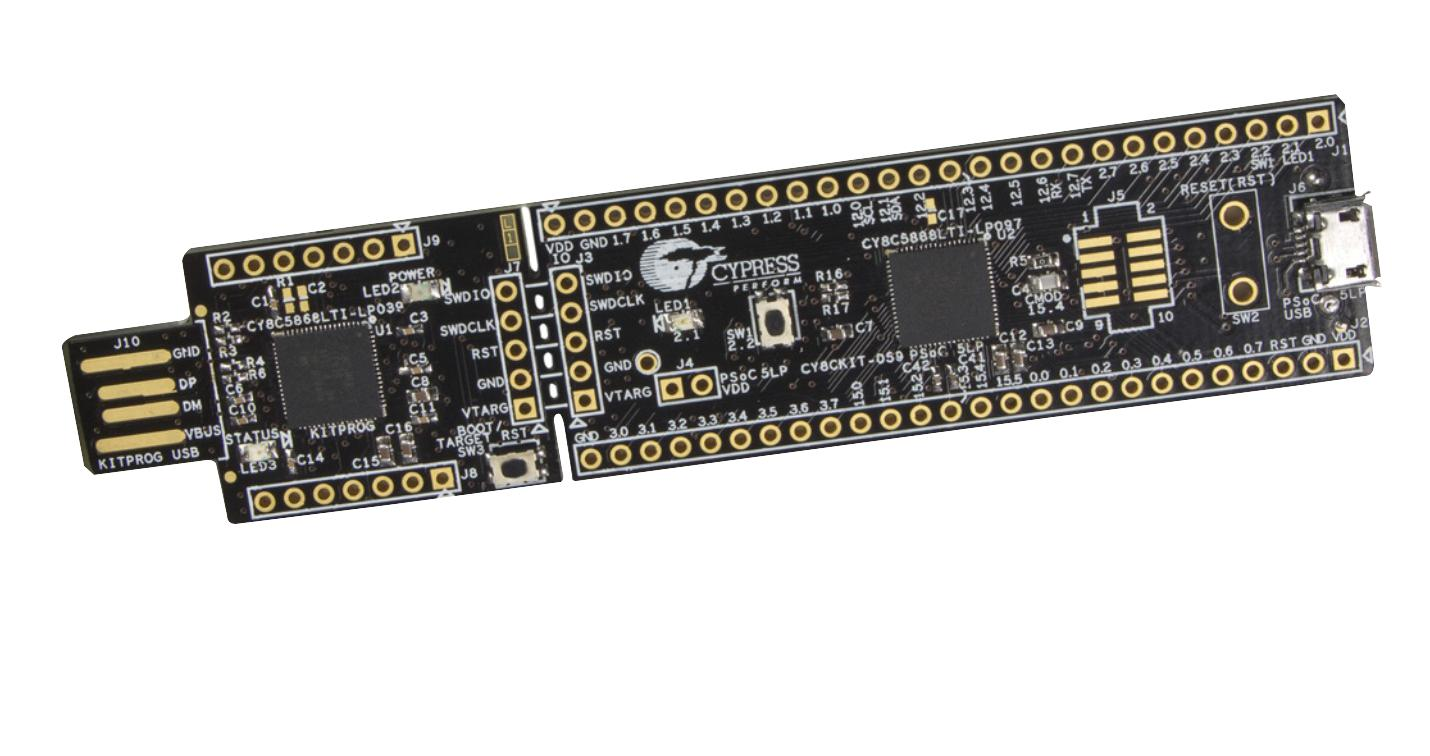

              And finally, at long last, psoc 5 in a pocket friendly form. Bonus is that you actually get 2 psoc 5's on the board. (There is also an additional CY8C5868LTI on the board.) So if a user graduates to a boot loadable project on the main psoc, then the one used as a kitprog/rammer can be re-purposed for another project if so desired.
              CY8CKIT-059 DEV BRD, CY8C5888LTI PSOC 5
              http://uk.farnell.com/cypress-semico...ing/dp/2476010

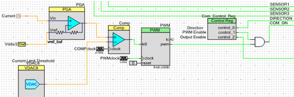

              As fixstuff mentioned in his posts on his experiments, these devices are not like ordinary mcu's. Using Cypress Creator suite (free download) you can actually create working projects that use "components" placed and configured in schematic capture-like window. So beside having a mcu there is also configurable digital components (clpd-like ?). Making it possible to do things, and have them perform faster than if wholly created as a function in the main core. See attached example for a look at a schematic of configurable components. There is over 100 of these components just waiting to be explored - from muxes to flip-flops to timers to pwm to counters to opamps to comparators in various flavours. Like their advertising blurb says, " its not just an mcu".
Name:	Components example.png

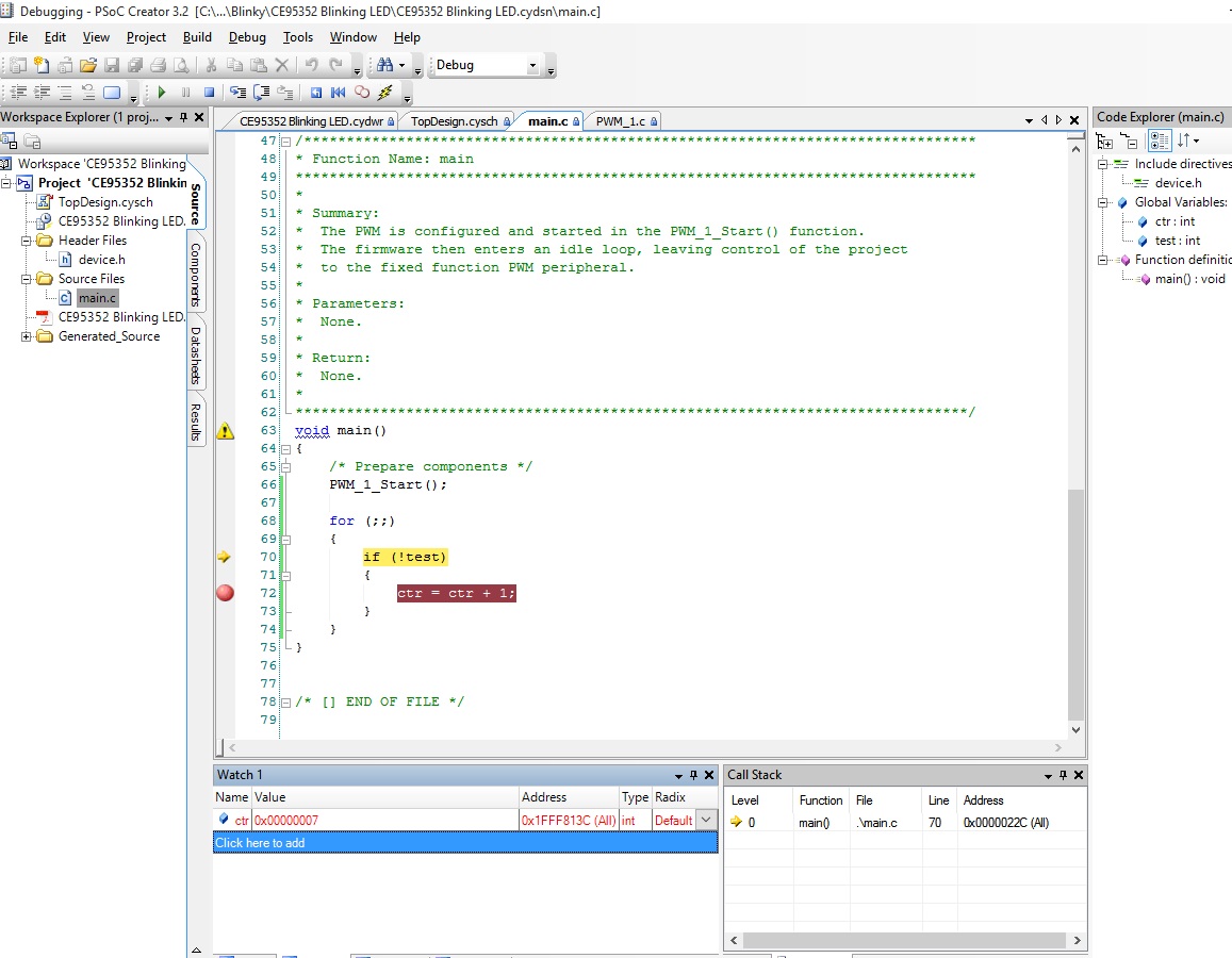

                  Good news on this.
                  I had a PSOC update the other day, and I hadn't tried to see if they fixed this but they had. The easy download is now working with this 059 kit now, so you don't have to use the downloader. One click and the program downloads and starts running. That's what you want. Easy Peasy.
                  Even the debug works for stepping through code with break points like this in the blinky demo, with a counter thrown in:
                  I will definitely work with this more now that is available. As a side note, it's freaky to see the LED still blinking while your in debug and single stepping...
