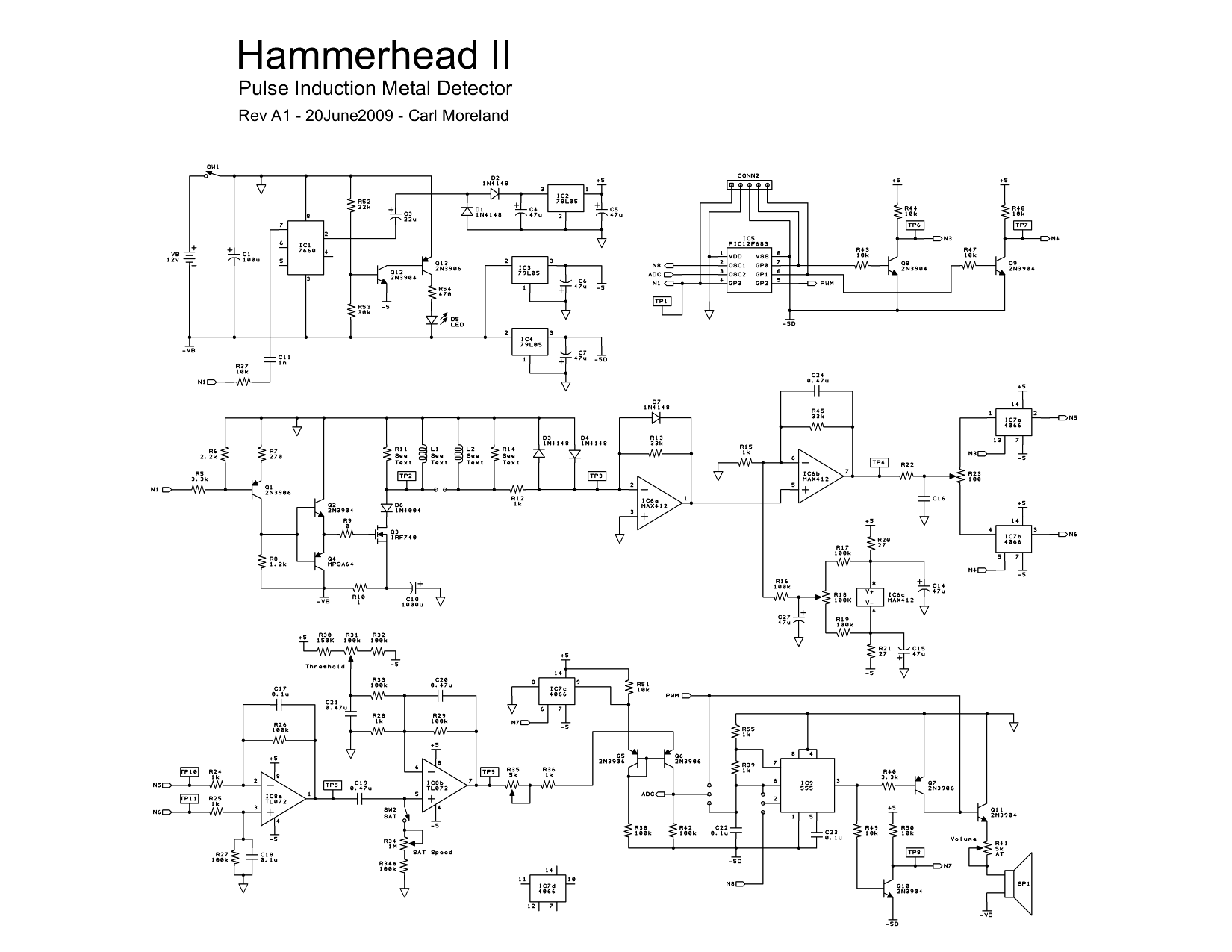

                To improve depth, you really need to have a 2-stage preamp. At the moment the preamp has a large gain of 60dB (1000x), but earlier sampling could be achieved if you were to split the preamp over two opamps, each with a gain of 30.4dB (33x). Have a look at the attached Hammerhead II schematic as an example.Click image for larger version

                    To improve depth, you really need to have a 2-stage preamp. At the moment the preamp has a large gain of 60dB (1000x), but earlier sampling could be achieved if you were to split the preamp over two opamps, each with a gain of 30.4dB (33x). Have a look at the attached Hammerhead II schematic as an example.[ATTACH]26676[/ATTACH]
                    ive never seen this version of the hammer head before...very interesting 2 stage preamp....is this pcb and pic availiable to buy ???? i noticed also in the new whites dual field the engineer claims that depth has been increased by more gain on the dc amp making weak signals more stronger.
                      i noticed with the hammer head diagram there is option for vco/non vco audio...can a switch be added so you can switch from vco to non vco or viceversa

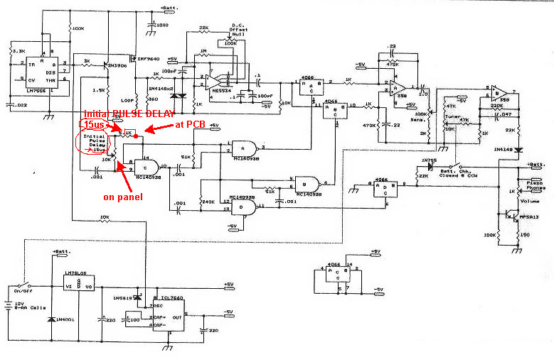

                        you do not answer me... you need tune a board's pot on 12-15us edge of SAMPLE DELAY... (while a second pot would be in zero Ohm position) THIS IS THE PRE-SET POT. while your second pot at panel you use for operative tuning from this value 12-15us (minimum of the preset) to 30 or more... or what you get there....
                          Carl might have some PCBs left. You'll need to ask.
                          The hexcode for the PIC is attached.
                              [ATTACH]26677[/ATTACH]
                              ive got myself confused....i have the silver dog surf pcb and instead of having a 10k preset on the pcb i have wired in an external pot and fixed on my control box....so i can adjust pulse delay...have i done this wrong ??????
