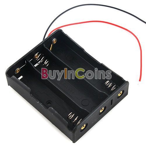

    Holder I found starting $1.23

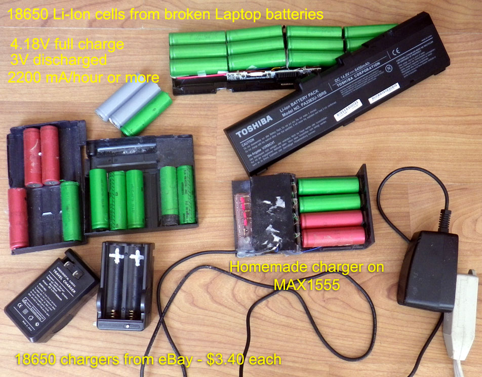

    Batteries form $1-2 each.
    But I mostly using 18650 cells from broken notebook computers because they are more fit to declared capacity then those you can buy on eBay.

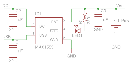

    Also you can make your own charger using MAX1555 ic

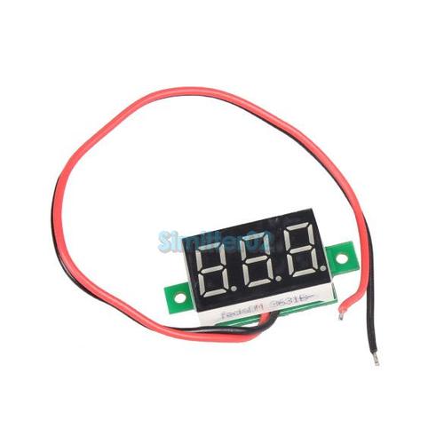

    Also you can buy miniature digital voltmeter starting $1.45 on eBay to know your power supply voltage.
    Search for "Mini DC 2.5-30V LED Panel Voltmeter".
    Just add a "battery check" knob or Reed switch and use magnet to turn it on if you using waterproof case for your detector.
