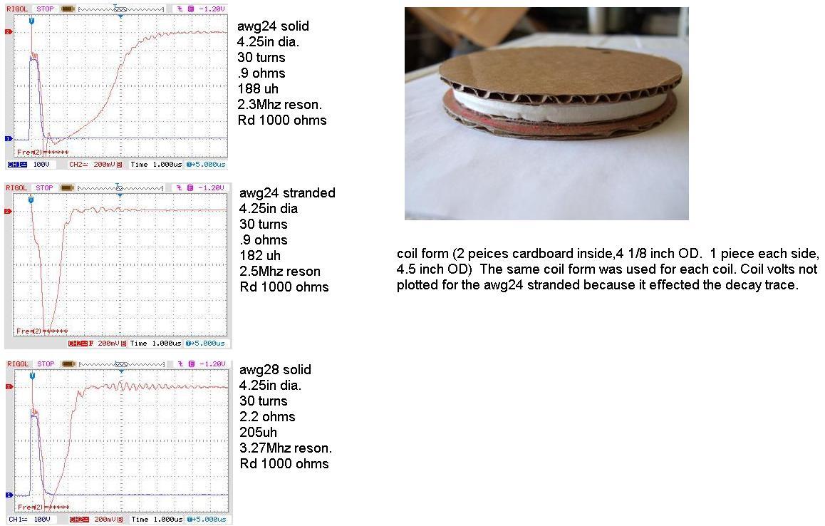

    (I was checking some coils that I have and saw something I didn't understand. Why a big difference in the decay time? Including a plot. Channel 1 is the coil volts, channel 2 is (U1 output mono coil amplifier reply#7), Rd is R5, Mhz is decay freq. with Rd disconnected. No target, no shield, 24awg is solid.)
    (Making a Fast Pulse Induction Mono Coil) says to use stranded for AWG 22 to 26. I don't have any 24 gage stranded. I tried some 28 awg teflon coated stranded to compare with the 28 gage magnet wire. A small difference. Should the coil response with 24 gage stranded look similar to the 28 gage magnet wire if coil specs are similar except for resistance?
      Generally, stranded is slightly better than solid, thicker insulation (Teflon being the best) has lower C but also lower L than magnet wire shellac, and smaller gauge wire has lower C but higher R than heavy gauge. It's a Big Trade-off Matrix.
      Your 24awg coil has a lower C (which should help) but also a much lower R which probably results in a higher turn-on current, which takes longer to dissipate. Try adding a series 1.6-ohm R to the 24awg coil and see if it gets closer to the 28awg response. This R may get quite warm.
        (Your 24awg coil has a lower C (which should help) but also a much lower R which probably results in a higher turn-on current, which takes longer to dissipate. Try adding a series 1.6-ohm R to the 24awg coil and see if it gets closer to the 28awg response. This R may get quite warm.)
        Thanks for the reply. I was using a 30usec on time to match the LTspice example I was using. I tried varying the on time from 30 to 100 usec and added a 2 ohm resistor in series at 30usec with the 24awg. I saw a time change of the 450 volt fet clamp. I didn't see a change in the curve after it came out of clamp,
          Also solid cooper wire instead of stranded wire holds eddy currents inside making decay little longer.
          You can cut a piece of solid wire and same size and AWG of stranded wire and try to detect it with your detector.
          You will see a BIG difference.
          It is good idea to make your coil from parts you can not detect to prevent it from detecting itself.

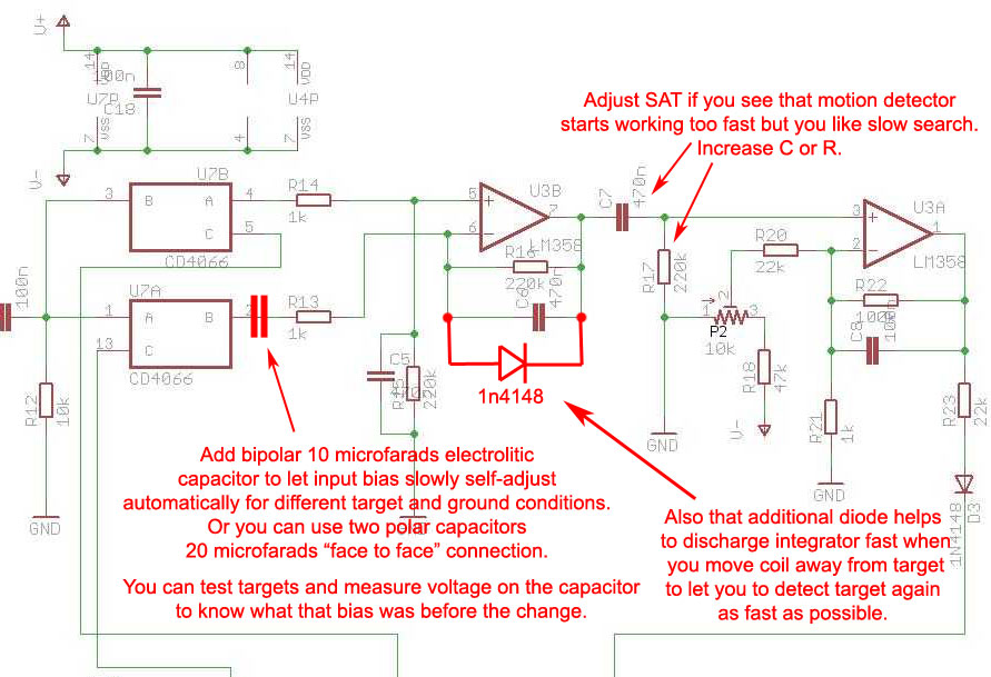

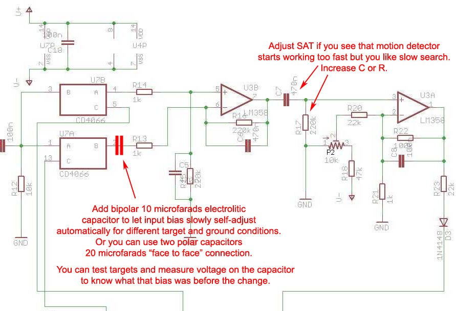

                        Interesting about the 10uF bipolar capacitor to the integrator input trick.
                          Integrator saturation in SurfPI sometimes is a problem.
                          Because decay curve is exponential you will always have a bias between samples. One sample always will be lower then other.
                          If difference between samples is big enough you will see OpAmp goes into saturation like +3.75 V is set on the integrator output and your detector stops reacting on targets.
                          Factors that may rise bias between samples and shift integrator into saturation:
                          1. Target is too big.
                          2. Target is too close to the coil.
                          3. Detecting in bad conditions like salt water or minerals.
                          4. Delay set is to short. (To find small gold)
                          5. Dumping resistor is too small. (Slope is faster and samples are more different in voltage).
                          6. Impulse is too long (providing more power to increase depth.)
                          7. Gain in integrator is too high. (Like it is in PI PRO schematic where gain was increased two times to increase depth)
                          8. Coil is to big generating stronger signals.
                          9. Capacitance of coil is to large requiring longer delay settings.
                          You can easily subtract that bias between samples and amplify only changes
                          by adding capacitor in line on integrator negative input.
                          Let say 10 uF bipolar electrolytic or two polar electrolytic that oriented + to + each other.
                          The capacitor will slowly corrects difference between + and - inputs of integrator.
                          As result you will never have a situation when your detector go blind over big target or bad ground, e.t.c.
                          because integrator starts to adjust to signal like motion detectors always do but for much wider dynamic range.
                          Also additional diode helps to discharge integrator fast when you move coil away from target to let you to detect target again as fast as possible.
                          Now you will have ability so search over bad ground because detector
                          will compensate that ground signal much better and show you only difference that target creates over the ground.
                          I saw some depth increase because instead of working on the edge in +3.70V - +3.75V range output
                          Integrator works in the middle range in much comfortable 0 - +0.5V output.
                          Practically I have measured voltage on the capacitor and see it changing somewhere between 0.3-1.6V
                          depending on conditions. You can see that 1.6V between + and - inputs of OpAmp will send OmAmp into saturation for sure.
                          Also that capacitor makes SAT reaction slightly faster. It is good for me because
                          I like to go fast but if you preferring slow searching you can increase capacitance or make a corrections to
                          SAT setting resistor-capacitor at the output of integrator.
                          Also you will see that integrator will settle output to 0 V after few seconds once you hit a target or some bad ground. So you need move your coil to detect as it always was.
                          Threshold setting has to be adjusted to work with that 0 V level instead of some constant bias up to +3.75V on integrator output as it was previously.
                          Good Luck!!!

                            My later schematic contains an additional diode that helps too much for good timing and fast detection.
                              I got some stranded awg24 pvc coated to try. Looks like the solid wire is acting as a target. Everyone says to use stranded. I didn't expect to see that much difference in the trace. Looks like the awg28 is a target also. I have been winding small coils to experiment with. Need to try a 10 inch coil closer to 300uh. Thanks for the suggestions.
                                Thank you for interesting experiments!
                                Picture 1 (awg24 solid) You can see that small spike after TX impulse end. Looks like coil just little bit under dumped.
                                If dumping resistor is same for all setups than "awg24 solid" has a little bit more internal capacitance.
                                As you can see lower self resonance frequency 2.3 Mhz proving presence of such capacitance.
                                Also interesting that awg28 is thin enough to reduce inter wire capacitance significantly.
                                Self resonance frequency go high even if it has more inductance because wires packed more closely.
                                Looks like switching on thin wires is a way to make a fast coil.

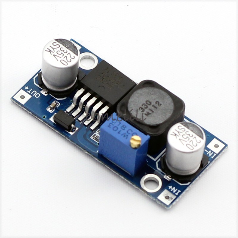

                                But thin wire has higher resistance and to keep same current we need longer impulses or high voltage power supply.
                                Easy solution is to use DC/DC step up voltage converter on LM2577 or XL6009 ($2 on ebay) to kick that high resistance coil with 36-50 Volts.

                                So thin wire coils have to decay faster because of lower inter wire capacitance and lower coil to shield capacitance. It is great to find small gold!!!!
                                Also such coils should be light weight: less wires, smaller shield, less plastic to hold construction.
                                And my favorite quality !!!!! - less drag in water
                                Can you try awg31 or even smaller but using higher voltage power supply? awg31 has five times higher resistance than awg24.
