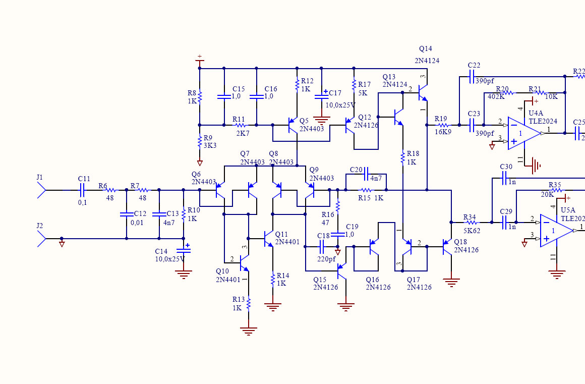

        These are surely very good amps, but for balanced input you need a balanced solution. THAT amplifiers are fine, but IMHO you can get there much cheaper, and surely more in spirit of a real DIY with plain old transistors. BC337 is cheap as chips and has Rbb well below 100ohm. If you buy a small quantity of these and match them, you can build a very fine balanced preamp for very cheap.
          I am sure you are right. I see big companies sometimes build preamps from transistors like Fisher CZ: Click image for larger version
          I see only one problem. Reliability of device depends on reliability of every component.
          Adding 20-30 discrete components will reduce reliability of hand made home build detector.
          One bad soldering and oops..

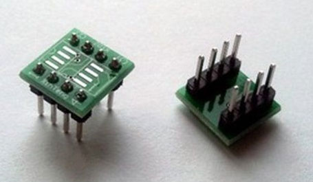

              I am disappointed too because it is impossible to find best new OpAmps in DIP (through hole) cases. Companies just do not want to made them in DIP.
              And every day you will sey that migration to SMD until all through hole chips will die like dinosaurs.
              But at least we have a solution to use SMD chips in our through hole PCBs.
              For several cents you can buy SOP8 SOIC8 SO8 SMD to DIP8 Adapters on eBay:

                That's more of a problem for mass production. True matched transistors are very exotic nowadays, and true low noise transistors are also not very easy to find. But as a real DIY-er you can make it work well with a proper choice of transistors. Heck - you are building it for yourself.
