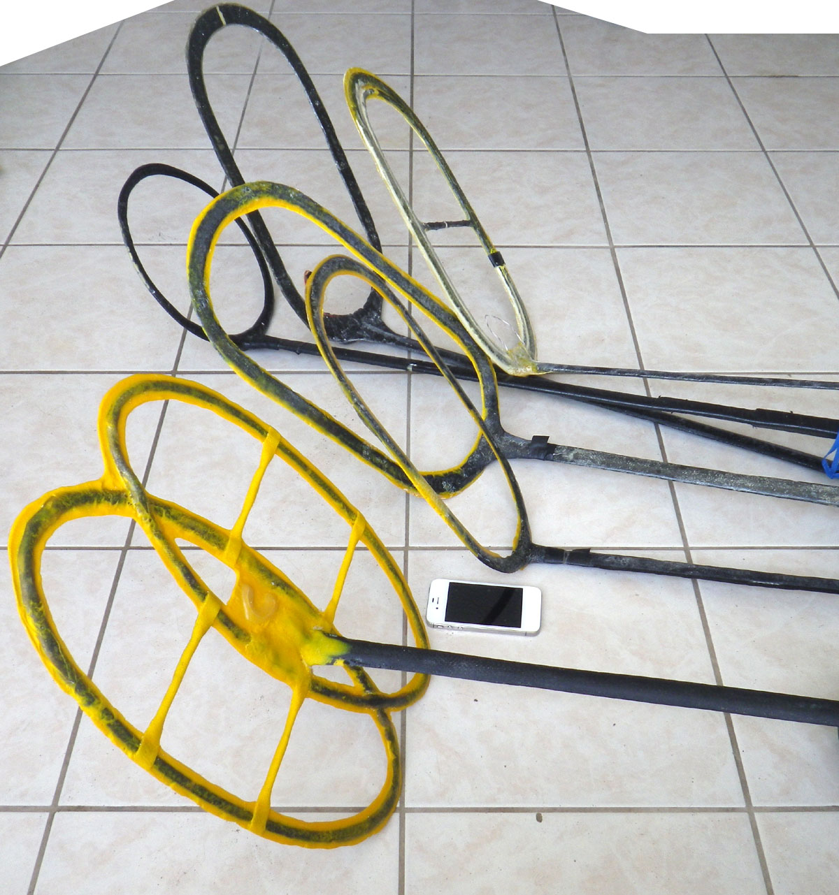

          Thank you for your input. My biggest problem is to make a coil with best hydrodynamic properties to let it move in water without drag.
          As I see no MD company move a finger to help detectoricsts searching in water to stop apply unbelievable physical forces to move detectors in water.
          I have made several coils with good results but best for hydrodynamic is a flat spiral which is 4-5 mm. thick including shield and fiberglass protection on bottom layer.
          But such a thin coil has no spacer between shield and windings. As result shield forms capacitors with begin and end of spiral windings converting coil to LC circuit and making it slow.
          Sure graphite is best for the shield. Also all coil surface have to be shielded or salt water will find a place where to form capacitor to ground and detector will start chattering.
          Resistor between shield and ground may help a little but because start and end of windings are close to the shield there will be a capacitor between them anyway even if I disconnect a shield.
          So now I maneuvering between coil construction and schematic solutions to continue to keep coil as thin as I can but make it decay faster to catch smaller gold items in salt water.

            I see where you want to have 3 to 4 mm thick. What outside dimensions are you trying for?
            • #66
              Ooo... It is pretty huge. 17" x 9". I like to cover some area too.

                Finally I have calibrated my oscilloscope and made some accurate measurement for my new flat spiral coil 18 turns AWG 24 stranded 19 strands Teflon 17" x 9" x 5 mm. thick 300uH with no spacer between shield and windings, graphite shield and Belkin coaxial cable. (You can see it at the back on the photos of my coils. One with gap in graphite shiels visible through fiberglass)
                Resonant frequency without damping is 435 kHz and with usual SurfPI gain=1000 preamp saturation lasts only 15 uS. (With 220 Ohm damping resistor which is to low for sure and have to be replaced with higher value)
                Looks not so bad. Much better than I have expected!
                Probably because of use Teflon insulated wires internal capacitance is not too big.
                And I am sure later I can even make it faster with reducing preamp gain and underdamping.
                12-15 uS delay looks OK for salt water to prevent chatters.
                Will go hunting with it soon.
