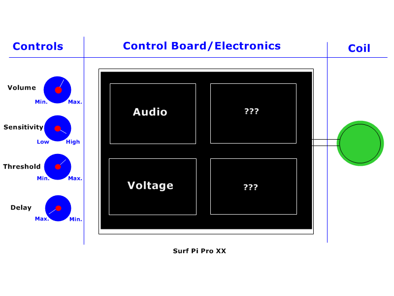

    1) With a metal detector, how many basic parts are their to the circuit excluding the coil ?, I'll use the surf pi pro as example, I know there is an audio circuit, voltage circuit and believe there is 2 other main parts but dont know what they are referred to as here. I made a small image map based on my own thinking since my trail cams have only 2 main parts and when put together make the complete circuit.
    2) Can a decent MD be made using a picaxe micro controller? I have and use picaxe 08m and 18x for my little cam projects, it was the easiest and quickest programming I could learn straight from their manuals and starter kits (along with plenty of help from friends), I tried pic basic but just wasnt catching on as fast as I would have liked.

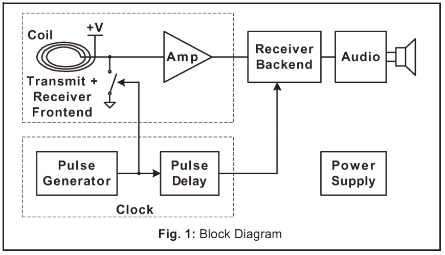

    I found this handy diagram in the Hammerhead documentation;
    Hammerhead is one of Carl's designs. His book will be a big help as it covers just about
    anything you need to know about metal detectors. I'm still saving for my copy too (as
    I tend to buy more parts instead).
    Looking at the drawing you see the basic PI flow chart. A TX pulse energizes the coil,
    after the TX pulse shuts off we look for a signal at a specific time, the threshold ignores
    noise and a good signal causes an audio output.

      Thank you for the relpy and the HH flow chart image, that was exactly what I was after. It gives a better picture of the basic circuits
      that will need to be put together, much appreciated. I'm not up on terminolgy so was not sure what you would call some of the other portions,
      that flow chart tells all.
